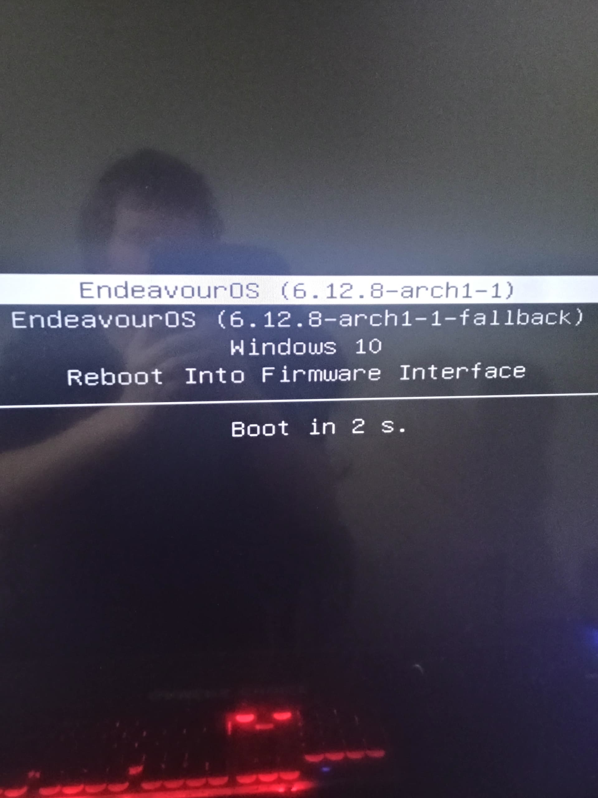

I cant use the fallback it gives me same.

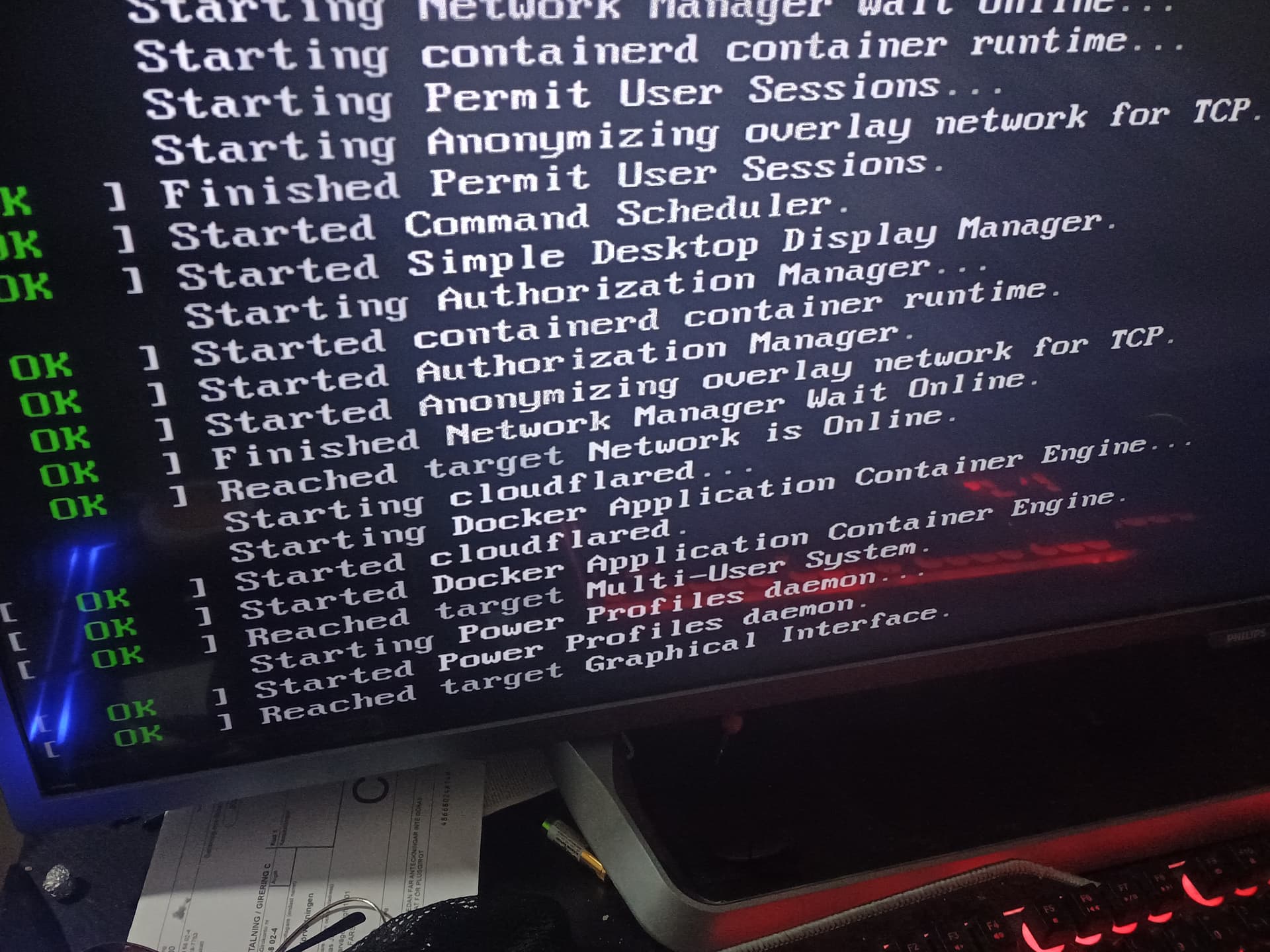

Like you see, it is when it comes to graphic interface.

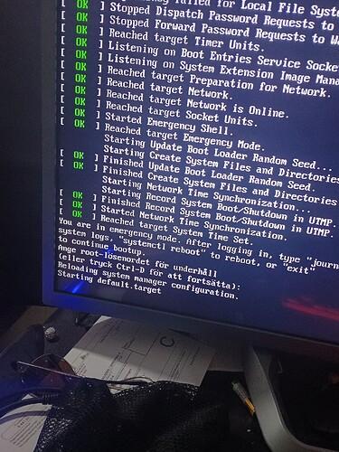

Now i installed a new EOS from USB and did restore from timeshift backup, now not starting at all :frowning:
