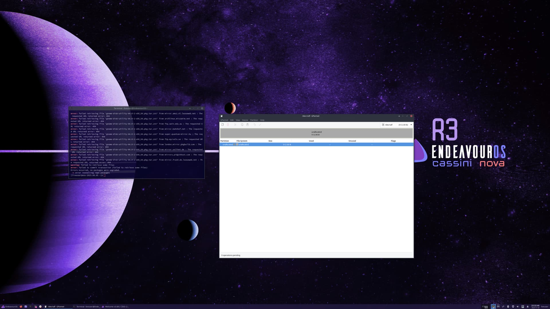

I did confirm it is 4 disks that do not show normally without doing the above commands + gparted, and here is a screenshot showing what all 4 of those disks show in gparted
Here is a screenshot of gparted showing the 4 disks as unknown

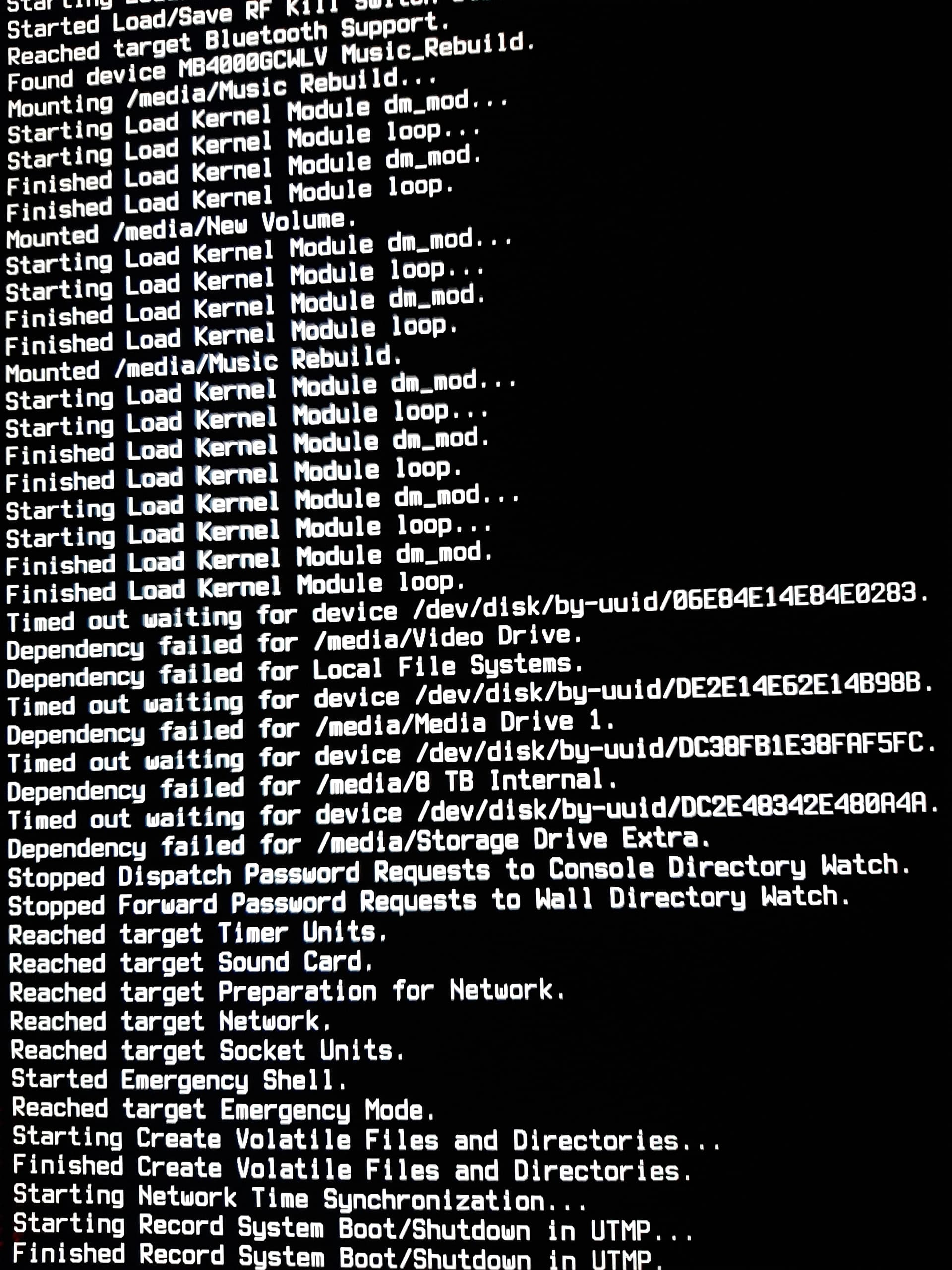

Since I got them all to be mounted and accessible I set them up to auto mount using fstab with the info from blkid, then rebooted and I am shown an error before boot for 4 disks shown in the following photo

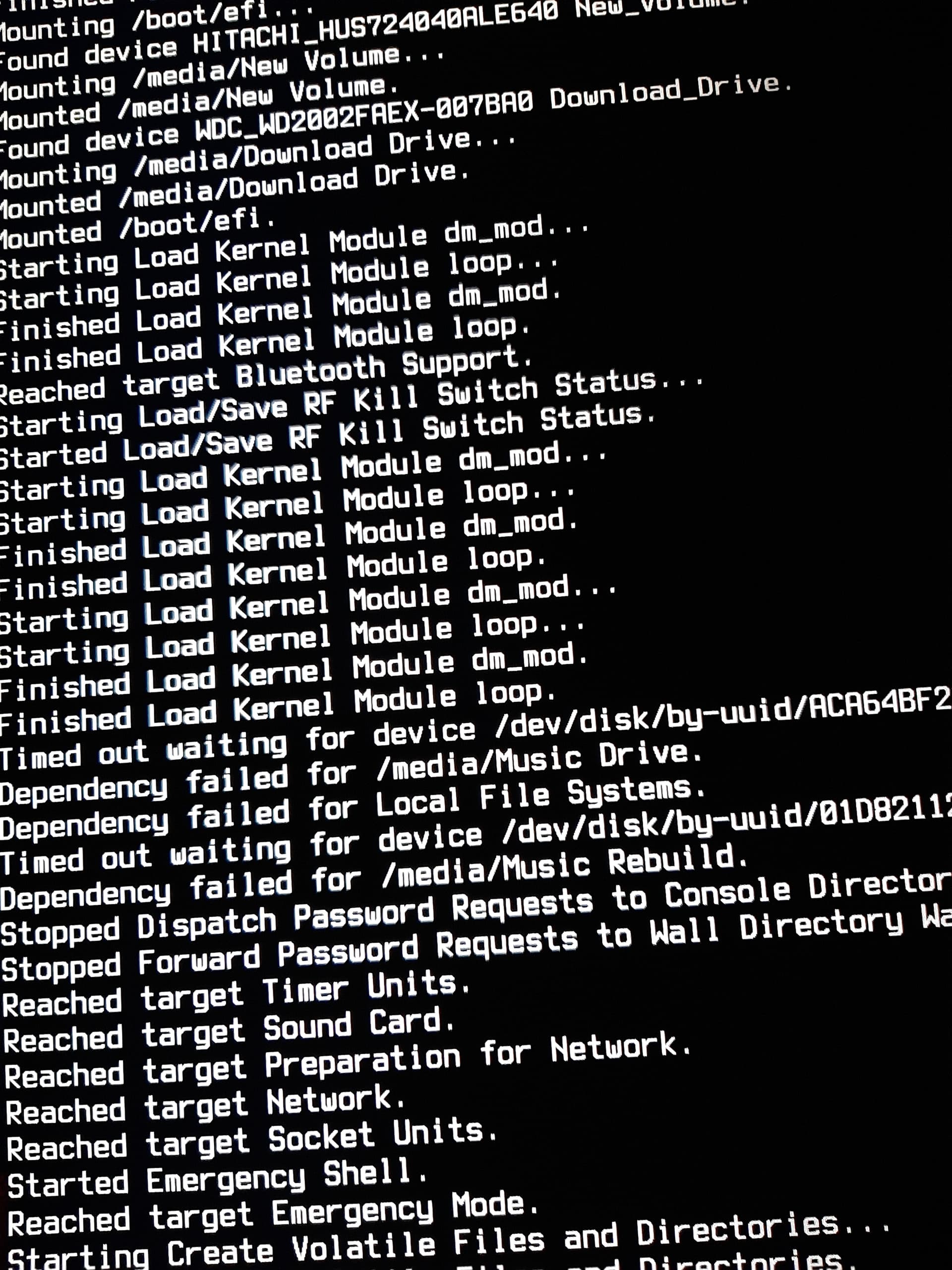

I then removed the 4 drives from fstab to see what’s what and then I see this
Some of the other disks not removed from fstab now showing dependency failed. Now I’m really confused.
