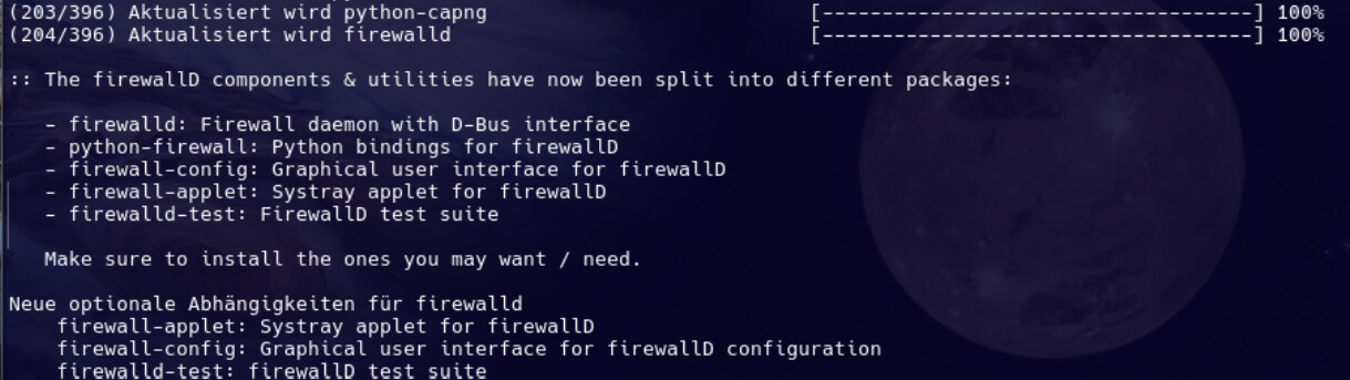

Also pacman told it:

should show it too thats with the package itself https://gitlab.archlinux.org/archlinux/packaging/packages/firewalld/-/blob/main/firewalld.install?ref_type=heads
this will show on updating the package..
I do yay -Pw before I update and that normally shows the news. Not this time though. I didn’t think to check when actually performing the update.
yea in casual manner arch is not adding such changes to the news, as it is not breaking the basic function. It was only update info shown with updating the package while you run the update.
