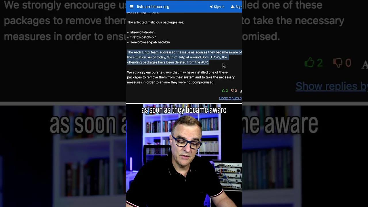

Apparently on the 16th July, malware was discovered on AUR uploaded by a user.
Packages that could be affected?:
libre wolf fix bin
firefox patch bin
zen browser patch bin
see 1 minute clip by David :
Should one remove & reinstall packages?
Thank you :folded_hands:
Did you install one of those packages?
Those are not normal packages that most people would have installed. Note the patch and fix in the package names.

No, it only impacts people who installed those specific affected packages from AUR.
Never heard of any of those. Actual AUR versions would be librewolf-bin and zen-browser-bin. There is no firefox-bin. But there is firefox-beta-bin and firefox-esr-bin.
Because they were only there for a short time until they were discovered. The names are obviously suspect though.
100%. Which leads one to realize that anyone running across those apps should have investigated further. Because anyone who’s ever dealt with Arch and the AUR should know better. At least, IMHO.
