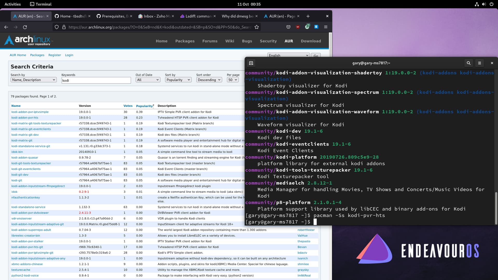

Wish me luck I have got to install kodi next with kodi-pvr-hts and kodi-audiodecoder-nosefart…
kodi search
dmesg needs root rights… e.g. sudo dmesg | grep frontend
and pacman does not handle AUR builds: :wink:
kodi-addon-pvr-hts ?
yay -Ss kodi-

kodi-pvr-hts - Tvheadend htsp client
https://kodi.wiki/view/Ubuntu_PVR_add-ons
https://aur.archlinux.org/packages/kodi-matrix-git/
This has been going for a while is that normal? like 30 minutes :confounded:
