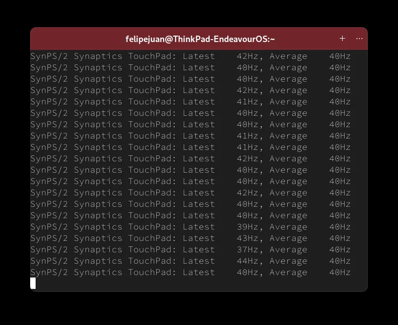

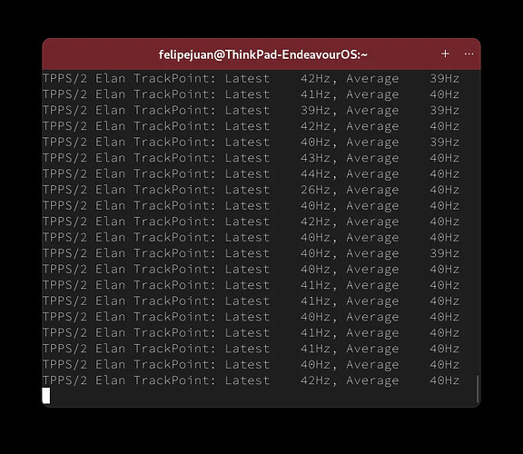

  1. TrackPoint polling rate is 40hz, which is so low and makes it seem so choppy/laggy all the time.

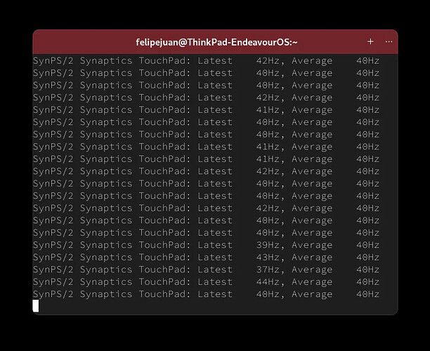

  2. TouchPad is usually 80hz when moving the cursor, but it’s also 40hz when using the two-finger gesture.
