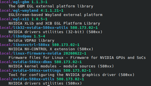

If I understand the output here correctly, you’re running the nouveau drivers, not the proprietary Nvidia drivers. Can you please show the output of $ pacman -Qs nvidia?
So… yeah, you don’t have the drivers installed. IIRC, nvidia-inst is a script that EndeavourOS provides to help out with this process. Maybe use that? That’s what I’ve used every time I used EndeavourOS.
If not, the Arch wiki is for you. I believe a 1070 is NV130, so you need to install the nvidia-580xx-dkms package from the AUR.
ok so things seem to be where they should be but now most games don’t launch at all. no idea if it’s related
had to delete web browser cache on steam as well as reinstall prism launcher for minecraft and now everything seems to be working again
I’m glad you got it working in the end!
