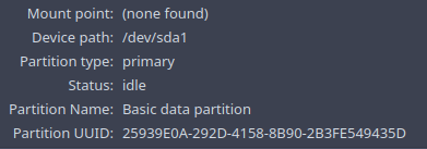

KDE Partition manager info:
KDE Partition manager_info
replace the UUID version with this version in /etc/fstab
/dev/sda1 /media/mydisk ntfs rw 0 0
then in the console:
sudo mount -a
assuming you have created the mount points before with:
sudo mkdir /media
sudo mkdir /media/mydisk
you can find out the right uuid in the partition manager but here particularly we can leave it be since you have no other sdx devices, so the BIOS can not go confuse them :slight_smile:

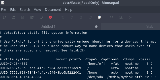

[panta@EVL340 ~]$ cat /etc/fstab
/etc/fstab: static file system information.
UUID=74C8-4807 /boot/efi vfat noatime 0 2
UUID=1637e96b-5ade-41b9-b984-ad229771ac69 / ext4 noatime 0 1
UUID=7721bf1f-7343-4d4e-a540-8bc6b5222001 /home ext4 noatime 0 2
UUID=30A494F1A494BB34 /dev/sda1 /media/mydisk ntfs rw 0 0

can you post the entire /etc/fstab content once again please?
there is something wrong in line 1 and 11
fstab_
line 11 is wrong, you need to cut out UUID …
so that is looks like:
but is there a line above the first line I am seeing on the image , can you check again ?
oh stop line one is actually this:
please DO NOT REBOOT , before you check that UUID
seems also incorrect eventually !!

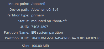

in the part manager, right click /dev/sda1 - properties
and please post the UUID of the boot partition
that would be:
/dev/nvme0n1p1
Its up there. Re-post KDE part manager info:
KDE Partition manager_info 1
we need the the UUID from:
/dev/nvme0n1p1
KDE Partition manager_boot
now you need to change the first entry
which ist the line where the UUID got to short:
in /etc/fstab, with
UUID=*** /boot/efi vfat noatime 0 2
where the *** are you need to copy out the right UUID and place it in
but careful no errors allowed otherwise you have a boot problem,
but do not worry we check it again afterwards, you post the result again please

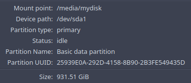

So, fstab should look like that:
UUID=78A3F06E-65FD-45A3-B6DA-7E8DD4C82FF0 /boot/efi vfat noatime 0 2
UUID=25939E0A-292D-4158-8B90-2B3FE549435D /dev/sda1 /media/mydisk ntfs rw 0 0
the 4th line should be:
I just compared the boot efi entry on my notebook, it has also a short
version, sh we should maybe leave the 1st line as it was:
Correct?
that should be it ! :slight_smile:
closing with:
sudo mount -a
