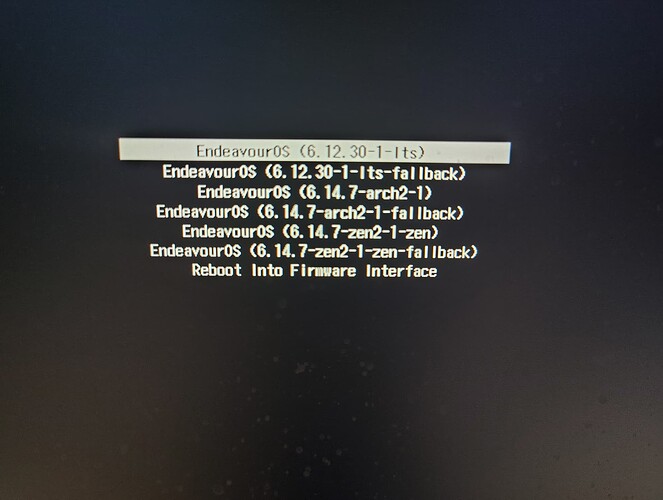

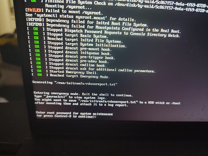

Loading kernel LTS Linux fails to boot
When I load Linux LTS kernel it fails to boot but when I load Zen it loads flawlessly I don’t understand the problem if anyone can help me out it would be great I get these error messages or whatever:
Oddly when I load Linux Zen the kernel it loads perfectly fine.

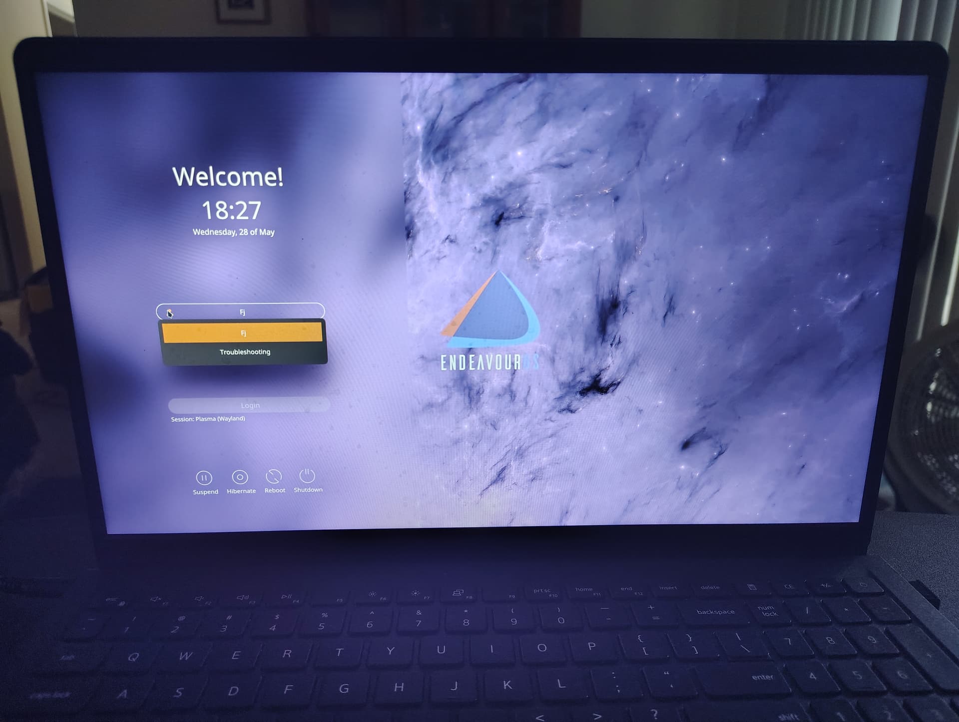

Luckily like Uncle spellbinder told us to do in his troubleshooting advice I installed multiple kernels:
Uncle spellbinder also recommended that we have two users on our PC our main one and a troubleshooting one I did that but that’s not related to this current issue. stillwise advice though
If anyone can help me understand me understand why Linux LTS won’t load that’d be great hopefully the error message give you some kind of hint again Linux Zen the kernel loads perfectly fine
Thanks so much the community on here rocks for real :grin::folded_hands::+1:
