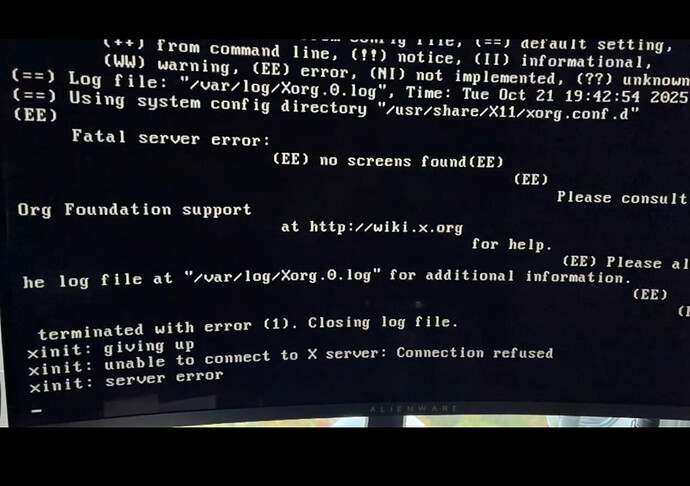

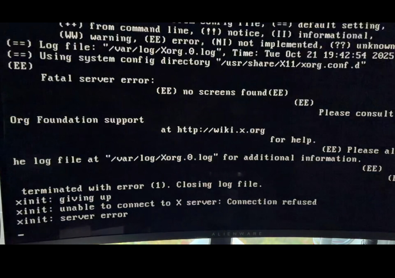

with an iphone 240fps recording i am able to see that the failure that blinks by includes a x11 failure to launch due to no display, so it is display related.
Curiously all 3 boot options fail in the same way. (the regular, the nvidia one, and the nomodeset)

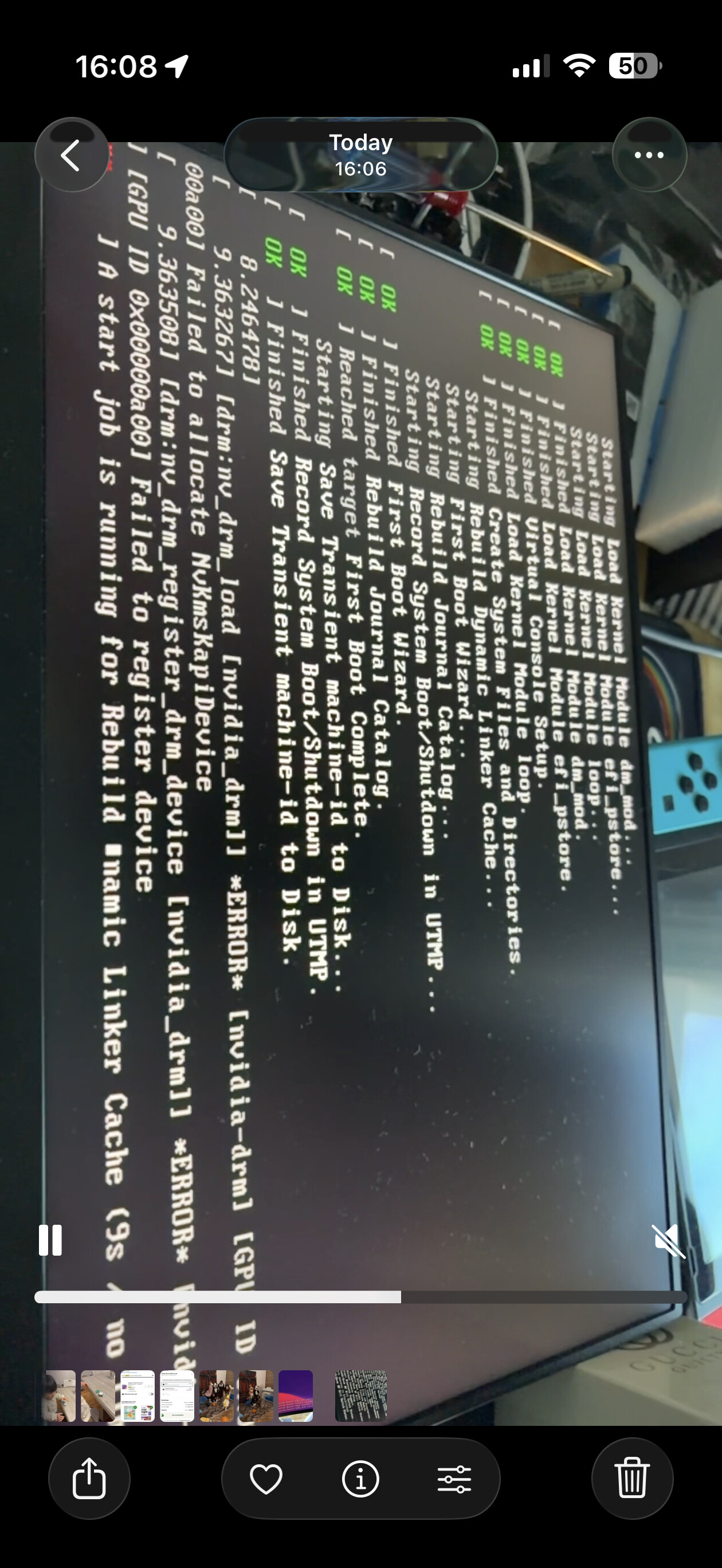

When I choose the nvidia option here is the error prior to the x11 fail:
I also tried with a different monitor connected to HDMI instead to see if it helps, it didn’t.
The internet states that this particular failure with Blackwell GPUs is due to not running the -open driver.
Presumably the -open nvidia driver isn’t the one bundled for the 2nd boot option. Wonder if the boot menu could be manipulated to help this.

I own a 5070 and never had issues booting the live system or installing. I just chose the option for newer nvidia cards so i’m not sure if OP uses the most recent .iso and it would also be interesting what OP uses to flash the .iso , since i have zero issues with ventoy or etcher.
Blackwell works well on Mercury Neo, just boot, open cli
sudo pacman -R nvidia nvidia-utils
reboot
then
sudo pacman -S nvidia-open nvidia-utils
reboot
Done :slight_smile: Rock solid and stable.
Yeah I don’t understand why my particular system has the failed to allocate NvKmsKapiDevice when others don’t.
