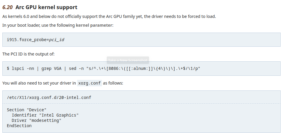

As the ISO does not boot with xf86-video-intel and the latest Intel GPU, we could simply add a new boot entry for Intel GPU without xf86-video-intel?
The Intel Arc cards needed i915.force_probe=pci_idkernel parameter with kernel 6 and below. The cards are supposed to be supported by open source kernel drivers soon. kernel 6.2?
Edit: But i think because they aren’t supported by the Intel driver it needed to be removed? I’m just not sure as i don’t have one of these cards. ![]()

Will need some research still… could be it needs some implemented stuff on kernel to work by blacklisting module or even without any needed change and could even be it could work without the need to remove the X11 driver… and it would load properly side by side…
