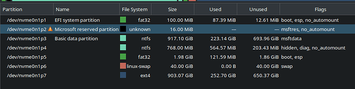

The efi partition is 100 megs and has 65 megs unused but I’m down for removing the old ones. I’ve never done that before…is it just same procedure of mounting and chrooting then deleteing everything under /efi?

Ahh…are you sure you don’t have two? The installer would never install systemd-boot into an EFI partition that small.

**somehow i increased the size of used space on nvme0n1p1
Err I see two ESPs. Which is which?
Do this and post output ‘lsblk -o UUID,name,size’
oohh snap I just realized that perhaps the p5 is Linux and ive been messing with the Windows one on p1…
Yes. Exactly.
OK that seems to have let reinstall-kernels work… Lets hope I didn’t mess up my windows. Testing time, brb
No luck…Now I have 2 windows entries and efibootmgr doesn’t show anything Linux related…reinstall-kernels executed though.
EDIT: I feel like i’m doing something wrong because I separately mounted both *p1 and *p5 under /mnt/efi and chrooted in and when I cd into efi it looks like the same contents. I think I can use efibootmgr to remove the double windows entry but thats where I am at.
