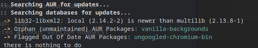

Not sure why a 32bit package update is effecting 64 bit packages…
I just finished a full upgrade and did not get those errors. Which 32-bit package are you referring to?

it broke (won’t run or launch) my ungoogled chromium work browser.
the dev, in the AUR, says
" Mackin_cheese commented on 2025-04-30 19:57 (UTC)
To those having issues with libxml2.
This is your system, you should know how to maintain it. If an AUR package is complaining about a missing library, you always do 3 things:
  1. Ensure you have the library installed.
  2. Perform a full system update.
  3. REBUILD the package to align with updated libraries."
    EDIT: I guess my first order of business is to find the library. Could not locate it yet.
