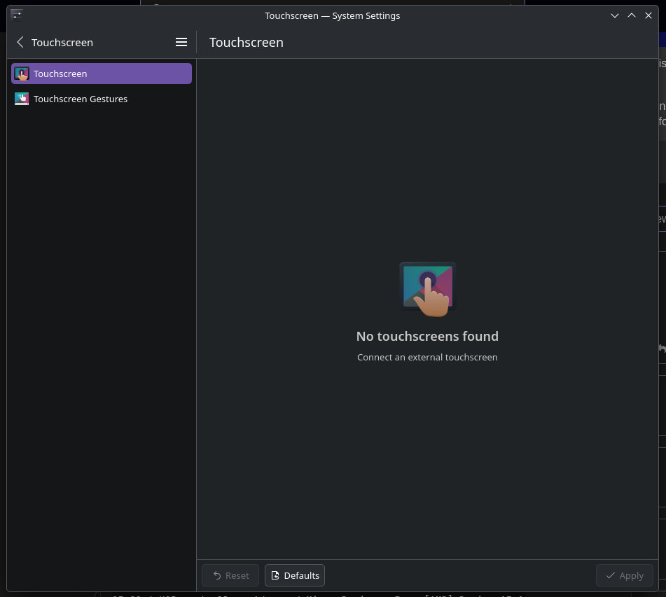

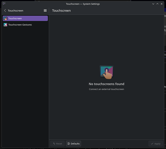

The settings page just says I don’t have a touchpad connected:
I don’t really understand what the arch wiki advises in this situation (https://wiki.archlinux.org/title/Touchscreen); I assume i should try installing xf86-libinput-evdev, but I don’t know how to actually do that. Do I just install it through yay/pacman and uninstall xf86-libinput-input? Will that break things? Is the touchscreen even being detected?
