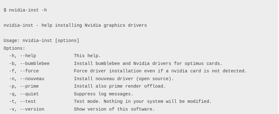

So should I use the nvidia-inst -b command to install the Nvidia driver and after that the Optimus manager?
No…
Edit: Don’t use bumblebee. It’s for older hardware. You should first try optimus-manager
