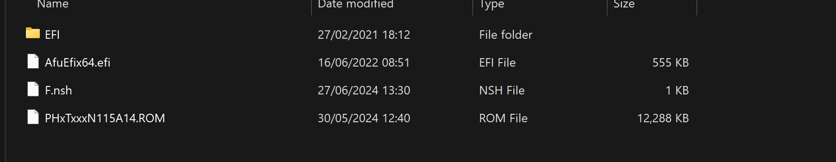

Hi @Flyred , Sorry for the late reply. That is the correct one,I used it and added it to my USB. I have attached screenshot the file i used
Thank you very much !!
I’ll follow their procedure (BIOS Update via EFI Shell) to install it.
When you installed the new bios. You have to make sure to turn on the laptop by holding the power button for 3 seconds; otherwise, it won’t turn on. You can tell it’s working by looking at the top right corner of the touchpad there will be a small flash of light. After that, it takes about 10–15 seconds for the boot logo to appear.
