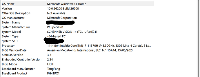

I’m guessing the new battery didn’t fix the issue. I bought a replacement, but nothing changed.
The good news is that I found a BIOS/EC firmware update not from PC Specialist, but on the Schenker website. When I searched for the Schenker Vision 14, I found several related laptop models. I can send you the file I used to update the firmware/BIOS. After the update, the boot logo is different. I had to be extremely careful finding the right bios file , it worked in the end
BIOS Version -N.1.15A14
EC Version - 2.24
I’ll let you know in the next couple of days whether this fixes the issue with struggling turning the laptop on .

Hi all !
Unfortunately this morning, the laptop showed me signs of the same behaviour. It didn’t want to boot with 22% battery.
So I guess the problem is not solved….
@zeez If you still have the file, It would be thankful if you could share it with me. Other wise I’ll try to look on schencker website. I guess you have downloaded Firmware_SCHENKER-VISION-14_M21_without-RTX-graphics_BIOS_N.1.15A14_EC_2.24.00.zip. After research it seems M21 is the correct version of my/ours laptop, could you please confirm it ?
