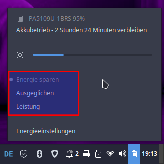

$ powerprofilesctl get
power-saver
although the Cinnamon panel shows all three:
EDIT: Sorry for the distraction, just found that you have to use
$ powerprofilesctl list

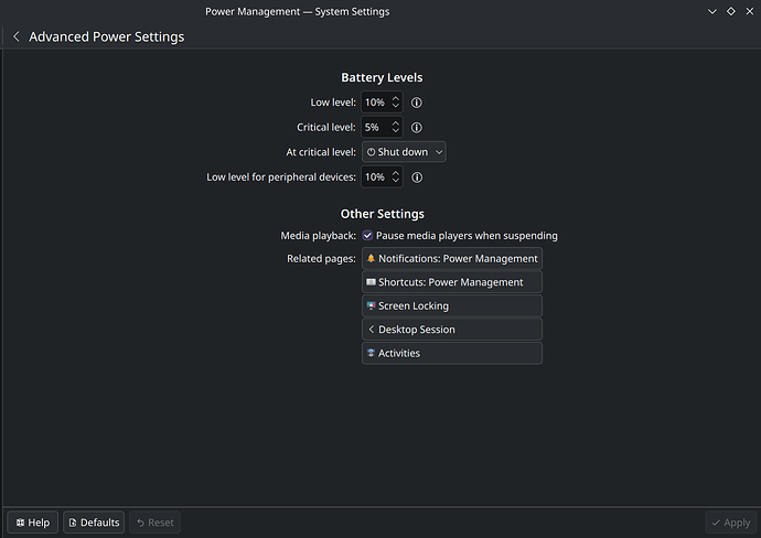

Check in the KDE settings Power Management → Advanced for the battery loading thresholds.

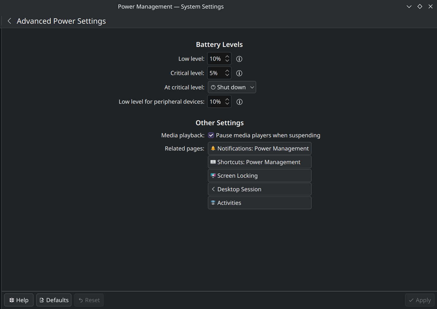

Unfortunately going to this place in the options doesn’t produce any options to change the charging thresholds.

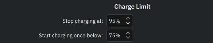

Was worth a try, here I have (even on an “ancient” seven year old):
But in the end that also only interfaces with the aforementioned /sys/class/power_supply/BAT#. Maybe it’s worth checking it out if there’s e.g. a /sys/class/power_supply/BAT#/charge_stop_threshold.
