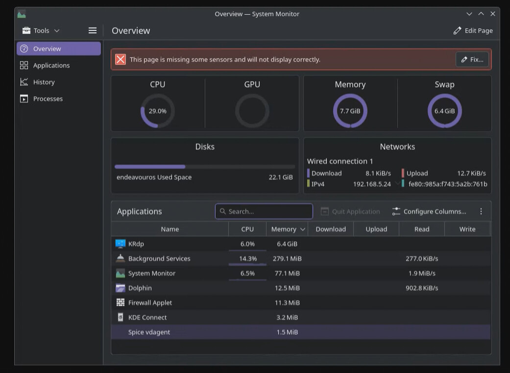

Hi Everyone,
I was wondering if any of you has even encoutered this issue with Kde Plasma Wayland and KRDP on Endeavour. I have installed the KRDP service to connect to a VM which has EOS installed on it. It runs plasma as DE but for some reason as soon as I connect to the VM with Remmina or KDRC the memory usage of the service start to increase until the kernel kills the service. It take a couple of minutes for the service to fill the ram and the swap. It’s not a small memory leak it goes up fast enough to make it barely usable (2 -3 minutes to fill 8 gb of ram). I’ve taken a look at the Kde bug list for KRdp and don’t really see a OOM issue beside this one : https://bugs.kde.org/show_bug.cgi?id=507949 which is not exactly what I have. Before creating a bug report on KDE I wanted to see if this is fixable in any way or related to EOS. Disconnecting does not make the KRdp service memory return to normal. It stays at the current value until the service is resetted by the kernel or restarted by me.
To recreate the issue you just need to connect to the vm with remmina with freerdp or krdc. THe ram should usage of KRdp should climb up pretty fast.

Sep 10 13:53:43 eos-vm systemd[763]: app-org.kde.krdpserver.service: A process of this unit has been killed by the OOM killer.
Sep 10 13:53:43 eos-vm systemd[763]: app-org.kde.krdpserver.service: Main process exited, code=killed, status=9/KILL
Sep 10 13:53:43 eos-vm systemd[763]: app-org.kde.krdpserver.service: Failed with result 'oom-kill'.
Sep 10 13:53:44 eos-vm systemd[763]: app-org.kde.krdpserver.service: Consumed 1min 20.868s CPU time, 6.3G memory peak, 5.5G memory swap peak.

that’s the issue it’s a memory leak. It will increase until it fills the ram and the swap. Adding more ram or swap does not fix the issue. It just delays the kernel killing the krdpserver.
After more digging this might be an issue with MESA : https://bugs.kde.org/show_bug.cgi?id=506521 So the only solution is to wait to be fixed or see if there is a bug report on MESA.
replying myself on this because I have found a solution. The latest MESA drivers 25.2.3 has a fix for exactly this problem. The thing is you need to set the VM Display in proxmox to VirGL GPU. After that the memory leak is gone.
