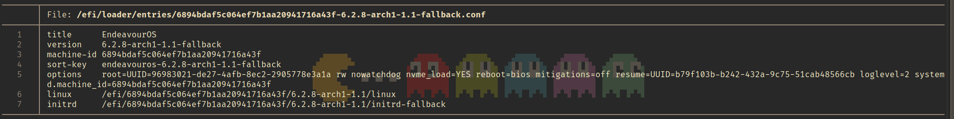

Het guys, after last update the system didn’t boot, the only boot option was “reboot into firmware interface”. I chrooted into the system from a live cd and apparently linux and initrd paths now have an extra /efi in the front???, i changed /efi/loader/entries/*.conf to not include /efi and now system boots, but after running kernel-install it stops booting again. Is there some sort of config I can change to not include the extra /efi ?
This is autogenerated config which does not boot:
After removing extra /efi it boots:
bootctl spec says that the path is resolved from mountpoint root, so it should not add that extra /efi (/dev/sda1 is mounted to /efi)

I have the exact same problem. Just remove the /efi/ prefix in our /efi/loader/entries/*.conf

title      EndeavourOS
version    6.2.8-arch1-1.1
machine-id 6894bdaf5c064ef7b1aa20941716a43f
sort-key   endeavouros-6.2.8-arch1-1.1
options    root=UUID=96983021-de27-4afb-8ec2-2905778e3a1a rw nowatchdog nvme_load=YES reboot=bios mitigations=off resume=UUID=b79f103b-b242-432a-9c75-51cab48566cb quiet loglevel=3 splash vt.global_cursor_default=0 systemd.machine_id=6894bdaf5c064ef7b1aa20941716a43f systemd.machine_id=6894bdaf5c064ef7b1aa20941716a43f
linux      /6894bdaf5c064ef7b1aa20941716a43f/6.2.8-arch1-1.1/linux
initrd     /6894bdaf5c064ef7b1aa20941716a43f/6.2.8-arch1-1.1/initrd
I am almost 100% certain that if you switch to ALHP now and reinstall kernels it will show the wrong path again
This happens on 2 physical PCs I tried this on
I does that now, I edited out the /efi
