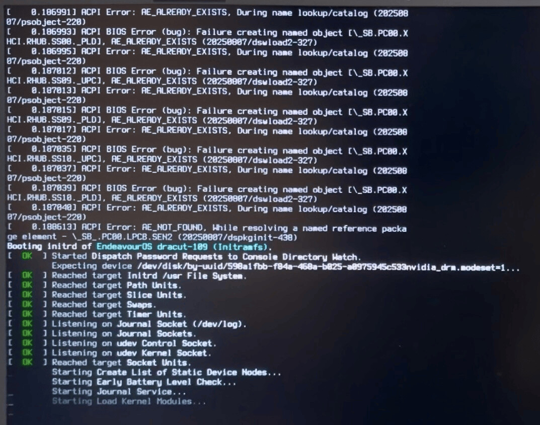

After that, I learned I needed to rebuild my Nvidia drivers (my config is listed below).

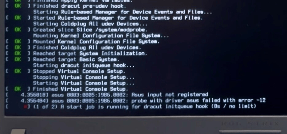

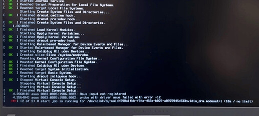

Again, after a bit of reading and commands I rebooted, but this time, it doesn’t seem to boot and i get stuck on a process (details below).

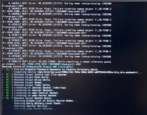

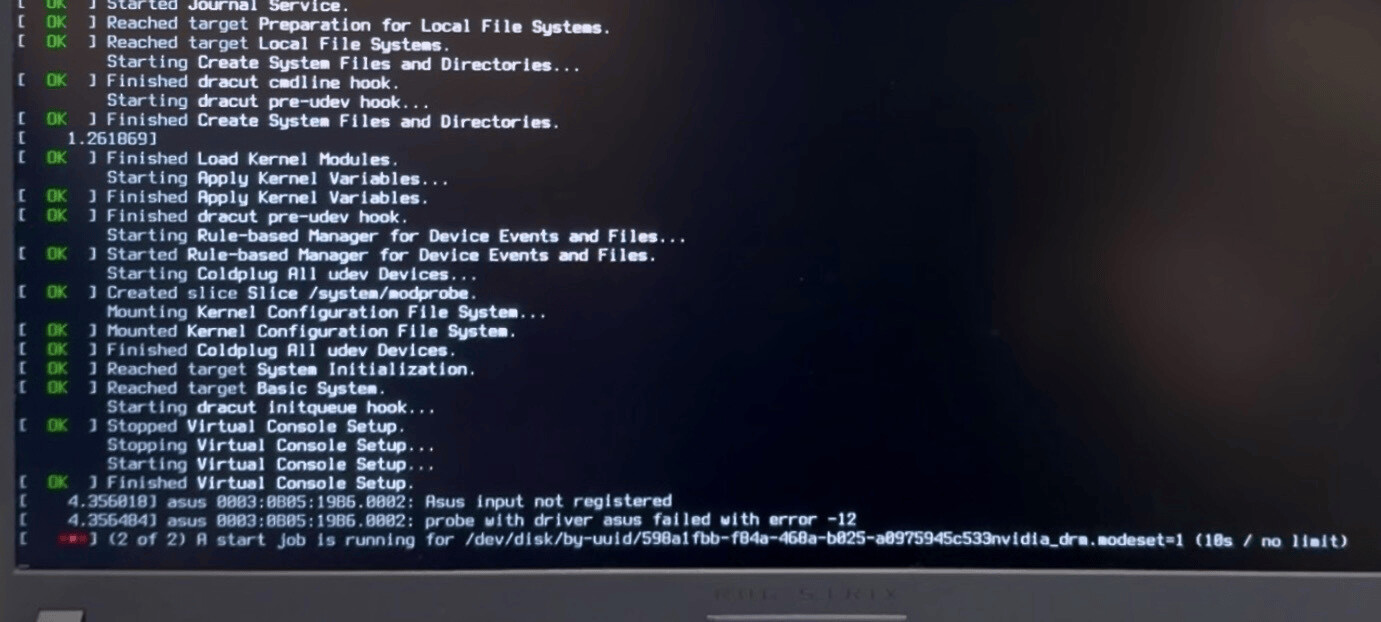

  • Thought I had it worked out, rebooted, and now I get the following (mb for the quality):

You can probably switch tty by pressing “ctrl+alt+f3”, then you will get a login console where you can login. Which nvidia packages do you have installed, can you share the output of pacman -Qs nvidia?
Thanks for the answer,
when pressing ctrl+alt+f3 i can indeed change kernel and it gives me 3 options:
normal/fallback/bios
The 2 first run into the same issue as mentioned above.
I can access the bios but nothing else, so i can’t do a pacman -Qs nvidia
I think a Chroot is necessary, as said by JBM
I’ll try that, thx for the help. I’ll get back when i succeed or have another issue :+1:
Looking at your screenshot your system should already be at the point where you everything is loaded, where you should be able to op another console which Ctrl+alt+f3 does. Not being able to load the graphics drivers shouldn’t prevent you from being able to do that.
Well, I don’t seem to be able to.
If I press Ctrl+Alt+F3 before the whole “[ OK ]” lines start, it gives me options to change the kernel, but that don’t work.
And if I do Ctrl+Alt+F3 when the processes start blocking, as shown in the pictures, nothing happens. Tried a lot of different shortcut combinations and also nothing.
