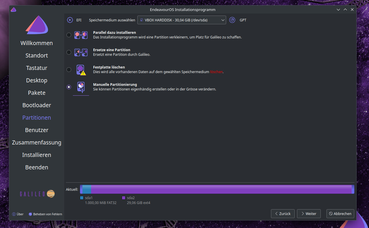

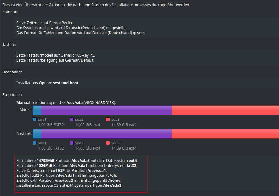

If you indeed have backup of the data… you can go to rename home folder of the current user (if you want to keep the username, set the old home partition as ,mounted on /home and do not format in deed inside installer manual partition. But this will only work if your home is a partition if it is a folder inside the current OS root file system… you will need to copy files back after install.
If /home is a dedicated Partition you can keep it only needs to rename home folder if you want to keep the username to be able to createvthe same username with installer… if home dir name already exists it would bail out.
You can use manual partition and only set mount point to /home on the old home partition.
After first boot simply copy the needed files over to the new users home folder at its needed places.
You can do this also after install by changing fstab to link to old home partition…
