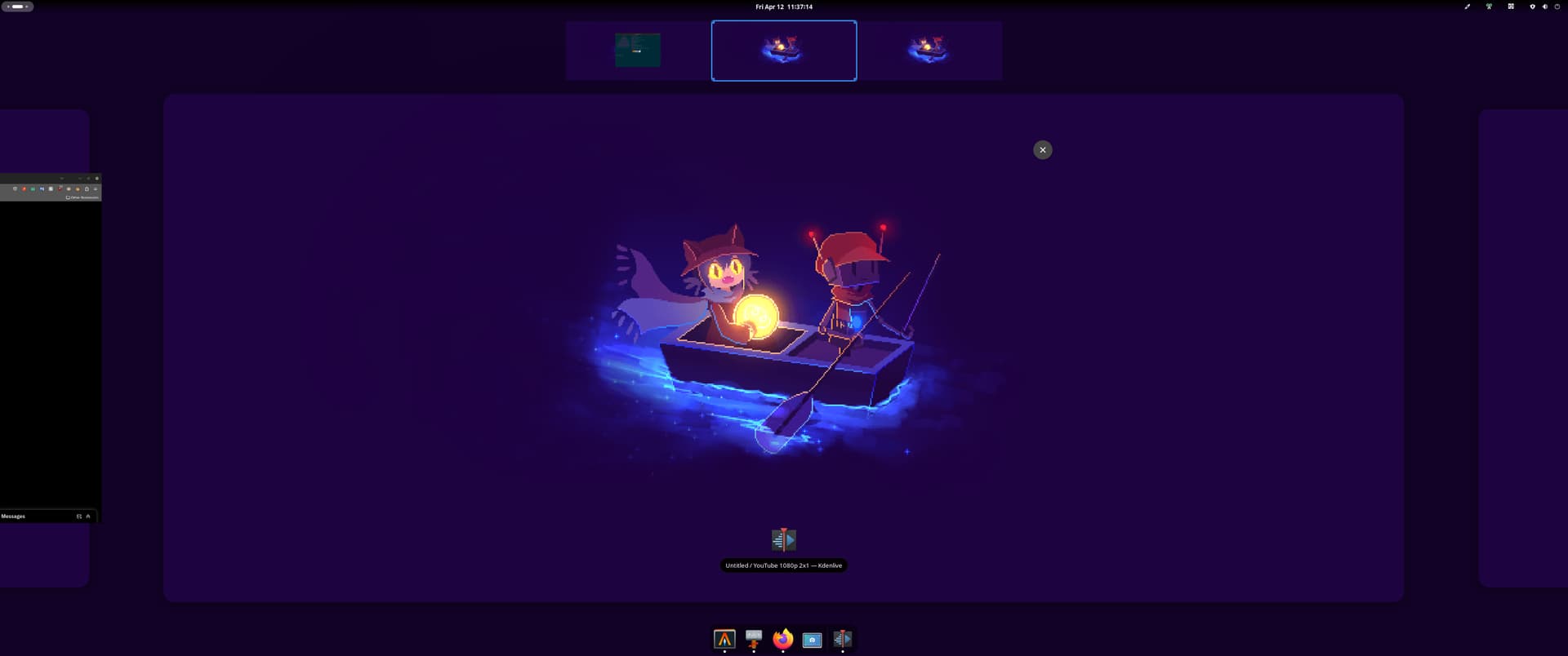

I have been using Kdenlive for over a year now and have been working on a project for the past week.
Everything was normal until yesterday. Whenever I open the app, I see the splash screen then seemingly nothing. When I press the meta key to go into overview, the program is there and invisible.
I can hover over the app icon in overview and see the option to close it, but I can’t seem to interact with it any other way.
I’m currently on Wayland Gnome 46 on Kernel 6.8.5-arch1-1.
The version of Kdenlive is the one available in the default repository installed through pacman.
I have tried switching to an XOrg session of Gnome with seeing the same results.
When I’m inside a Plasma Wayland session it appears and behaves normally.
I assume there’s something going on with my Gnome sessions, but I’m unsure how else to diagnose it.
