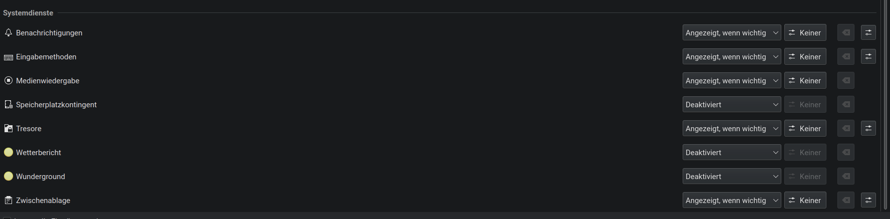

Es gibt tatsächlich in den Einstellungen des System-tray bei Plasma 6.0.3 keine Möglichkeit aktualiserungen einzuschalten. Das heisst es ist kein Menueintrag vorhanden.
Bei meinen System , Plasma 6.0.3, wird auch nur notify angezeigt.

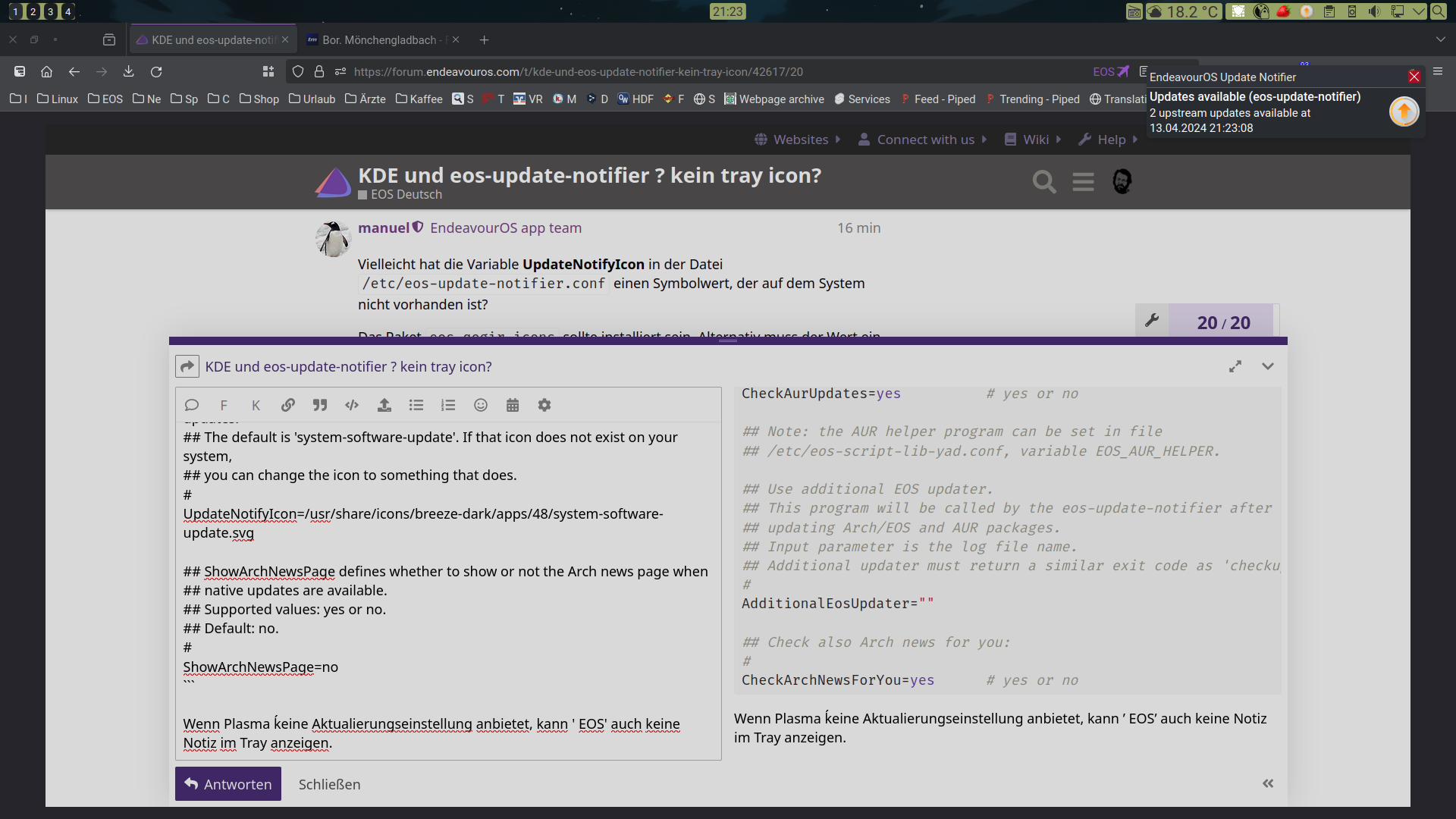

Das ist meine /etc/eos-update-notifier.conf
### eos-update-notifier configuration file
## Check also updates from AUR:
CheckAurUpdates=yes          # yes or no
## Note: the AUR helper program can be set in file
## /etc/eos-script-lib-yad.conf, variable EOS_AUR_HELPER.
## Use additional EOS updater.
## This program will be called by the eos-update-notifier after
## updating Arch/EOS and AUR packages.
## Input parameter is the log file name.
## Additional updater must return a similar exit code as 'checkupdates'.
AdditionalEosUpdater=""
## Check also Arch news for you:
CheckArchNewsForYou=yes      # yes or no
## Check news while updating?
AllowNewsCheckWhileUpdating=yes   # yes or no
## Program for showing the Arch news.
## 'eos-arch-news' shows news based on the date and shows the news
## only if there are newer news than at the previous check.
## Note: 'arch-news-for-you' was outdated and is now removed.
## This option was added in eos-update-notifier version 0.9-1.
ArchNewsProg=eos-arch-news
## Prefer tray notification or small window for nofitying about updates?
## NOTE: if clicking the tray notification icon launches also the next panel item,
## a workaround is either to
##  - re-organize panel's notification area icons so that 'Yad' is not the first (uppermost), or
##  - add an empty launcher right next to the tray notification icon.
ShowHowAboutUpdates=notify+tray     # value: 'notify', 'notify+tray', 'tray', or 'window'
## What info to show about pending updates ("number of updates" or "package names");
## applies only when 'ShowHowAboutUpdates' is set to 'window':
ShowWhatAboutUpdates=number  # values: 'number' or 'packages'
## Specify how long time the notification window will be shown until it closes automatically.
## Refers to the following values of 'ShowHowAboutUpdates' (see above):
##  - notify
##  - notify+tray
## Valid values are:
##  - positive integers with a suffix 's' (seconds), 'm' (minutes), and 'h' (hours)
##  - 0 (notification window will not close automatically)
## Default for both is 30s.
UN_NotifyTimeout=0s            # for 'notify'
UN_NotifyTrayTimeout=0s        # for 'notify+tray'
## SyncAfterUpdate.
## Note: this setting was moved from here to eos-script-lib-yad.conf at 2022-Apr-28.
## UpdateNotifyIcon is the icon name that will be used when showing available updates.
## The default is 'system-software-update'. If that icon does not exist on your system,
## you can change the icon to something that does.
UpdateNotifyIcon=/usr/share/icons/breeze-dark/apps/48/system-software-update.svg
## ShowArchNewsPage defines whether to show or not the Arch news page when
## native updates are available.
## Supported values: yes or no.
## Default: no.
ShowArchNewsPage=no
Das sieht dann so aus:
Wenn Plasma ḱeine Aktualierungseinstellung anbietet, kann EOS auch keine Notiz im Tray anzeigen.

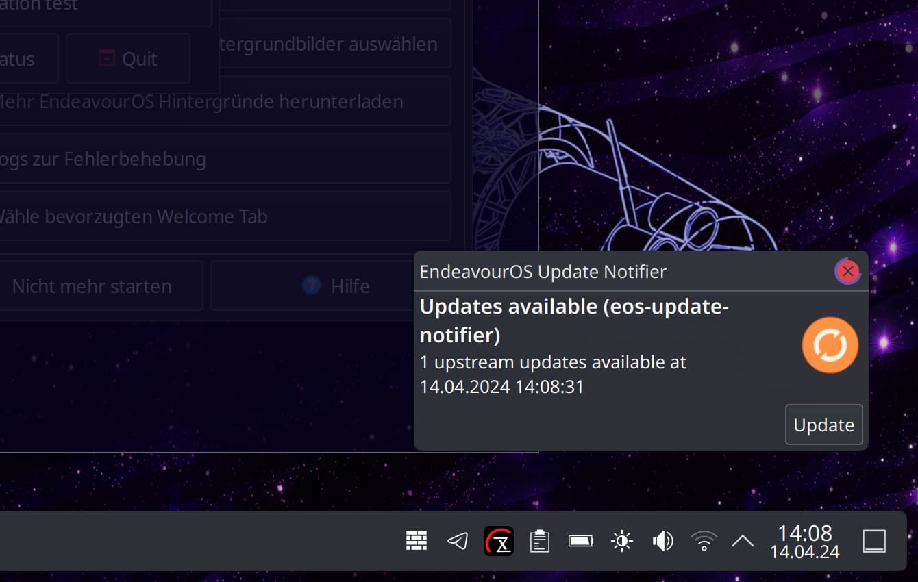

Zum testen zeigt es das Symbol an wie du siehst. Nur bei einem update habe ich nur das notify-Symbol.

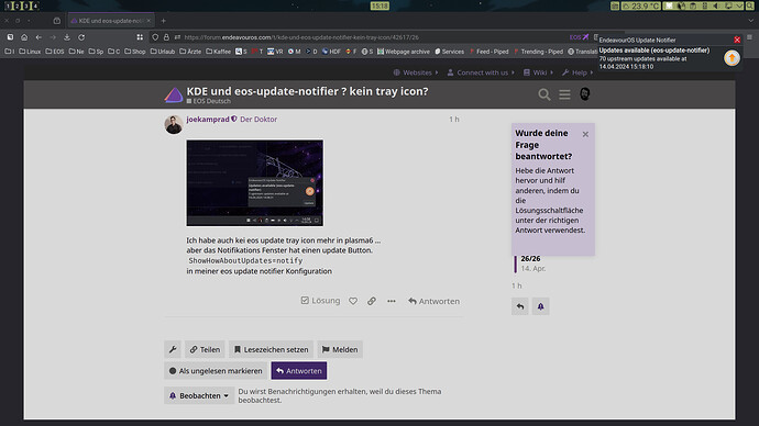

Ich habe auch kein eos update tray icon mehr in plasma6 …
aber, das Benachrichtigungsfenster, hat einen update Button.
in meiner eos update notifier Konfiguration

Just tried eos-update-notifier in Virtualbox VM, KDE and wayland.
Value notify+tray shows both the tray icon and the small notification window.
The only issue I found was the tray icon needs to be clicked twice, with one click it seems to do nothing.
In general, wayland and yad are known to have some (so far small) compatibility problems, and this might be one of them.
