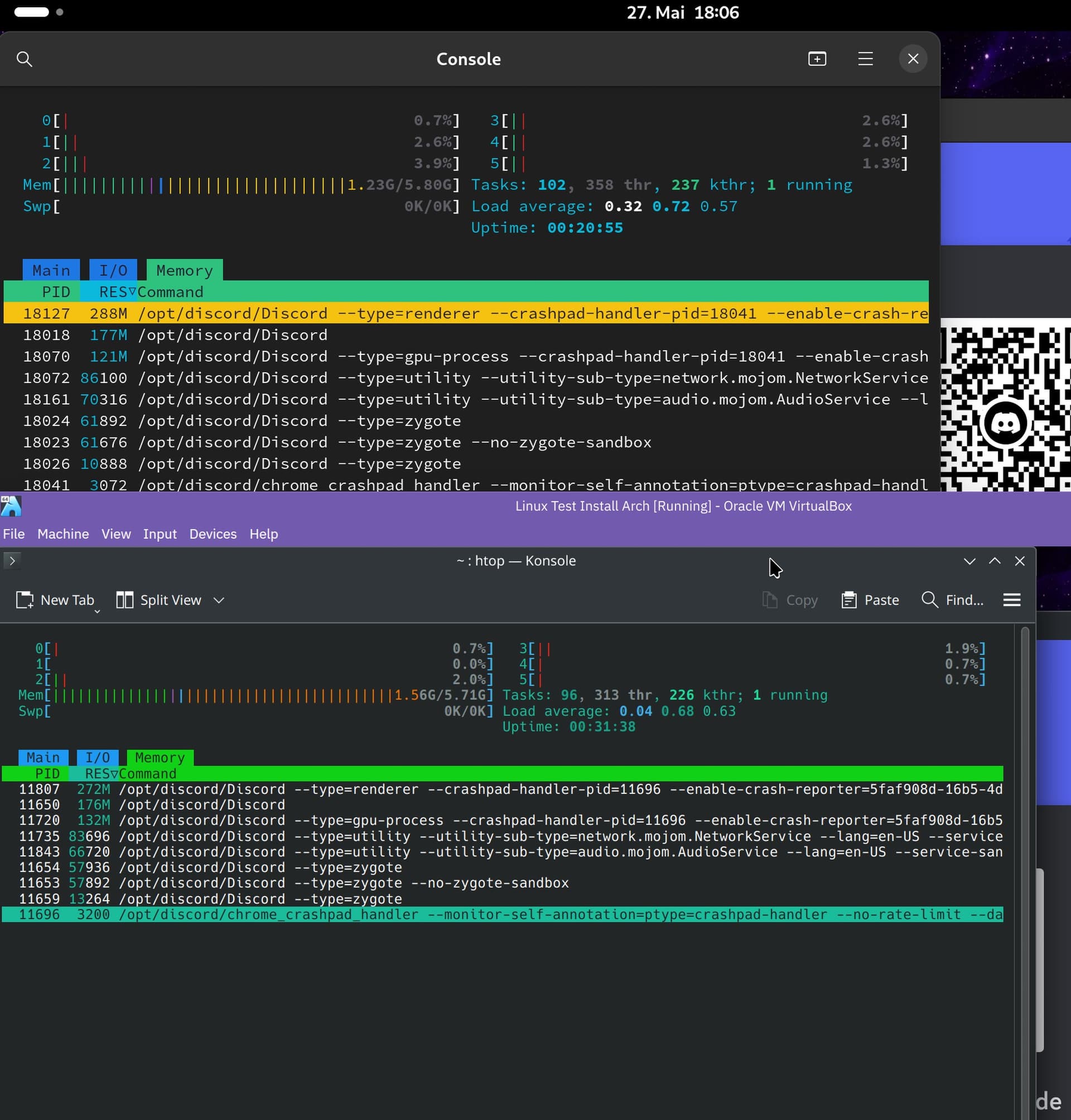

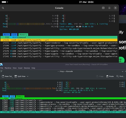

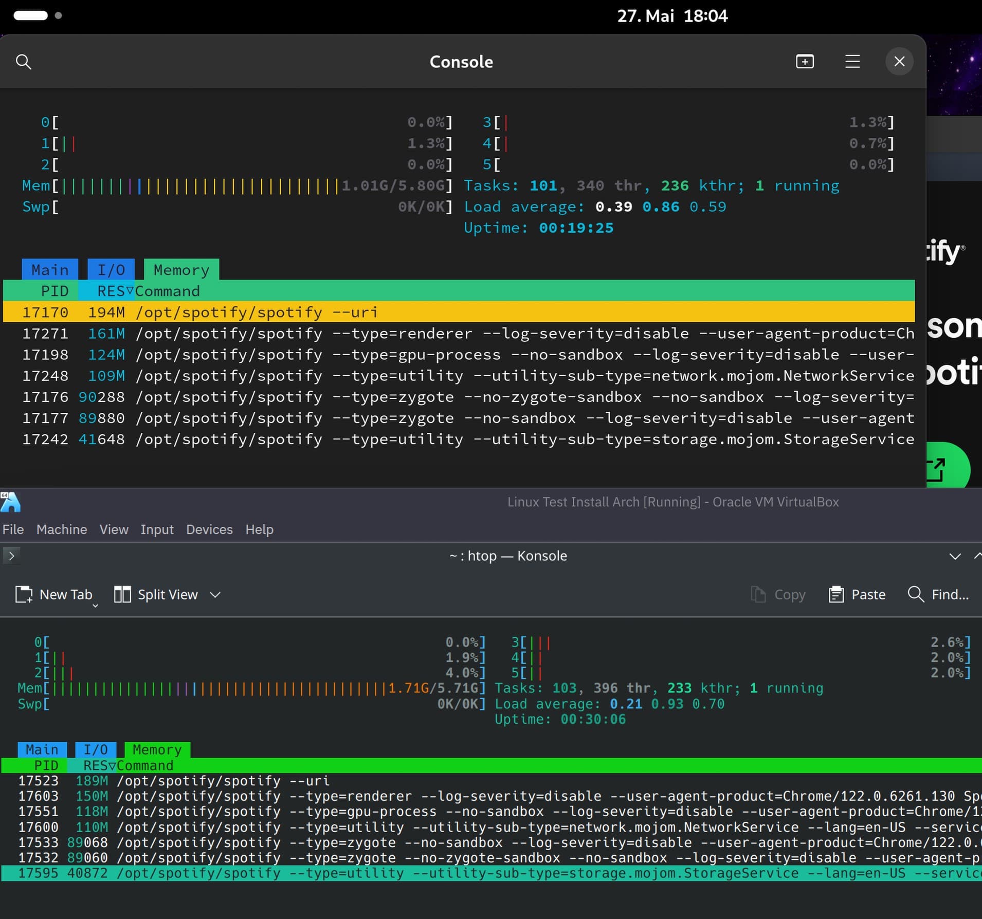

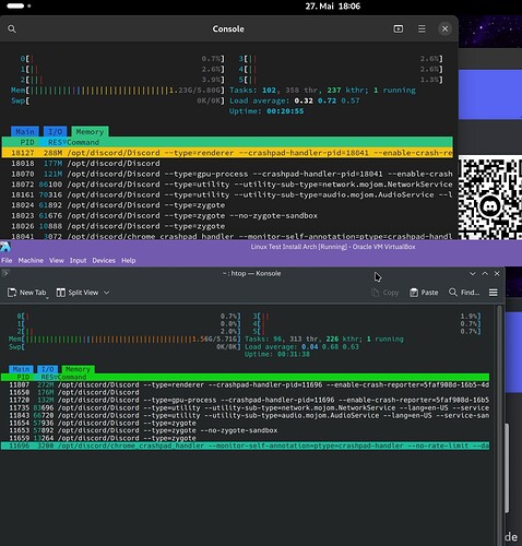

For the fun I spun up two VMs. First picture is Spotify, second one is Discord (no login, no usage, which of course would change things considerably). Looks virtually the same.
