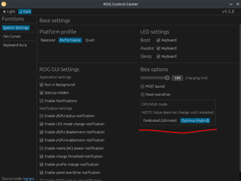

Ok, I also have an Asus.
I recommend installing asusctl and rog-control-center from the AUR. From there you can control everything that may interest you, including the MUX switch.
Oh, I have those two packages :slight_smile: I will have a try now
Perfect!, remember to update because not long ago they enabled the option to modify the MUX switch, it is where I point in the screenshot
