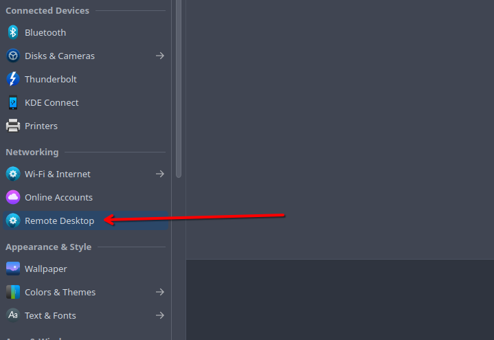

EndeavourOS (EOS) doesn’t come with ‘remote desktop’ functionality pre-packaged in KDE 6. I’m wondering if installing KRDP is all that’s needed to enable it? I’ve added KRDP to my EOS machine, but I’m unable to connect to it from my Vanilla Arch system using KRDC.
I’ve managed to connect successfully using this setup on KDE 6 between two NixOS systems, so I’m puzzled why it’s not working between Arch and EOS. Could I be missing something?
