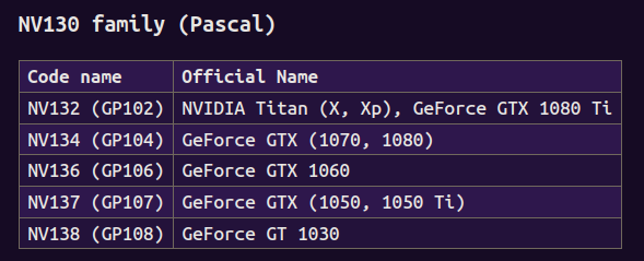

But will be NVIDIA Titan X / Titan Xp (Pascal Architecture)
should still work, may you created some dependency issue or installed something in the way.
