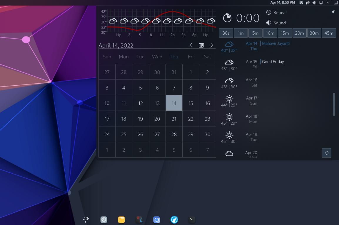

Hello everyone. From last 2-3 days, I am experiencing issues with widgets which I had pinned on taskbar. As the title suggests, the size of the tabs of widgets gets small when I click them to view :
11
But, when I change the position, everything becomes normal :
12
When again I restart the device, this issue comes back, and gets resolved by changing the position. This happens with other widgets, including the notification pop-ups, which become small and appear at central edge, rather than the top corner.

That is possible for the case when I pin the widgets on desktop. But, if you look at the image, the event calendar widget is not in its regular size, but when I change its location on taskbar, it comes back to normal size.
The issue is with widget icons which are pinned on taskbar, and also the notifications.

Yes. I tried that, and will only change the size according my need. But all those changes disappears after reboot and results in poor scaled appearance, and it get fixed if I change the widget position, as I did in the image shared.

Hi, just to put in some more information. I had some issues with event calendar and sticky notes regarding this display error. I found out that it happened with KDE framework update fomr 5.92 to 5.93
I filed a bug at KDE guys. Nate Graham said that there needs a fix to be backported to 5.93.
See my bug: https://bugs.kde.org/show_bug.cgi?id=452607
and "Master bug with Nate’s comment: https://bugs.kde.org/show_bug.cgi?id=452512#c5

it’s not an issue with the widget but with KDE framework. Downgrading event calendar wouldn’t help.
got fixed today with update
extra/plasma-framework 5.93.0-1 → 5.93.0-2
