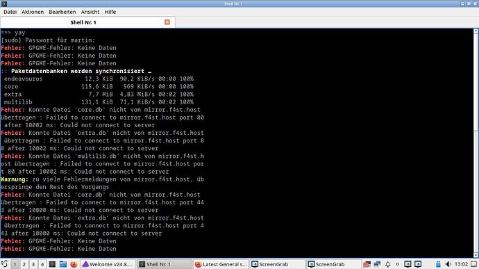

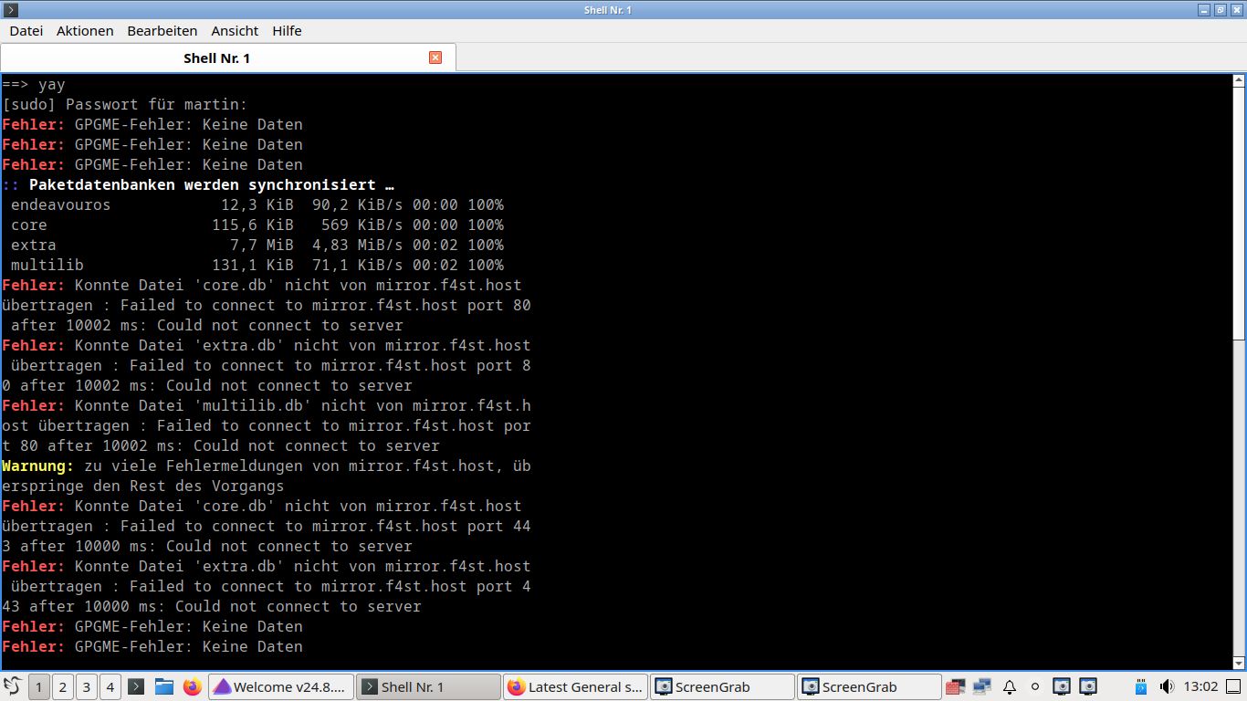

running eos on several notebooks - and due to the fact that i am not using them on every day i run into issues - of update. SEE what has happened on my x 220 notebook
well i guess that it is everytime the same - i have issues with the db - and with the update of the keyrings. I guess that i have to clean out some thing.

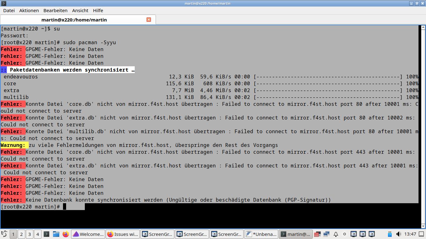

updqate: i did the following
sudo pacman - Syyu
well i guess that this in not fully successful
Not sure if this will solve your problem but the mirror.f4st.host seems to be not in use anymore, so you can remove it from your mirrorlist.

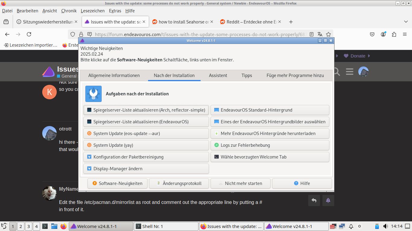

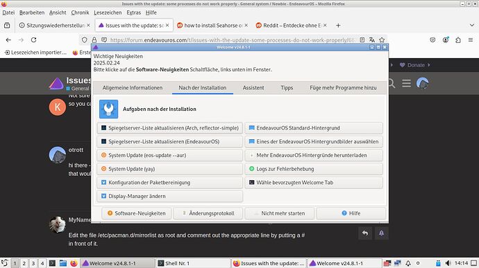

Edit the file /etc/pacman.d/mirrorlist as root and comment out the appropriate line by putting a # in front of it.

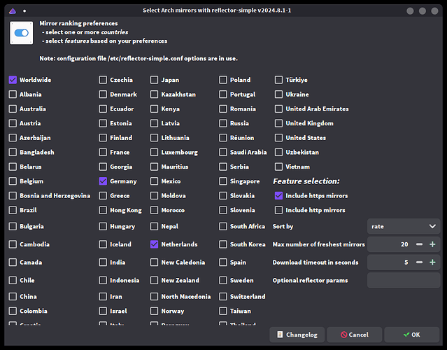

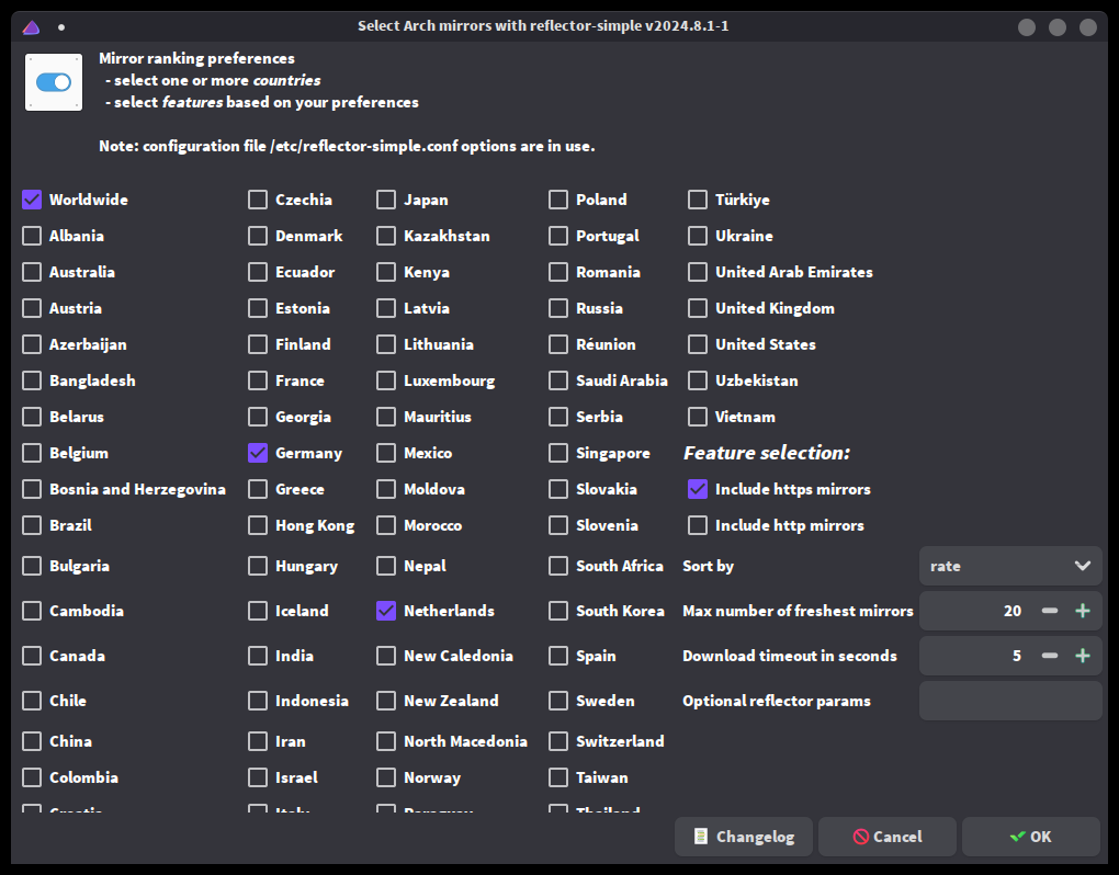

Probably best to update your mirrors.
hi there - many thanks i did this with the following - the wellcome bla bla
and i choosen the second line in the options .which showed me a list of worldwide countries - where Germany was picked - i ticket it of and choose
austria
belgium
denmark and
chezch
hope that this will work now

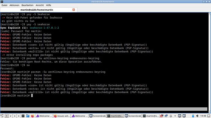

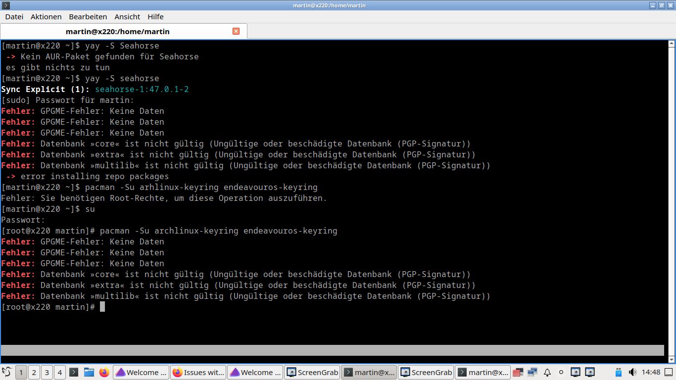

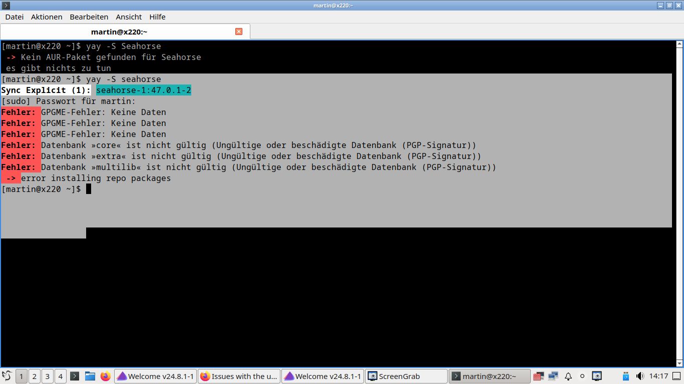

updatte: well i t seems that i was not lucky - i tried to install seahorse - but it failed
it still fails all the time - due the issues with the mirrors - i guess
i need to fix this

well still i think that i have to fix the mirrorlist… still this is the thing to do

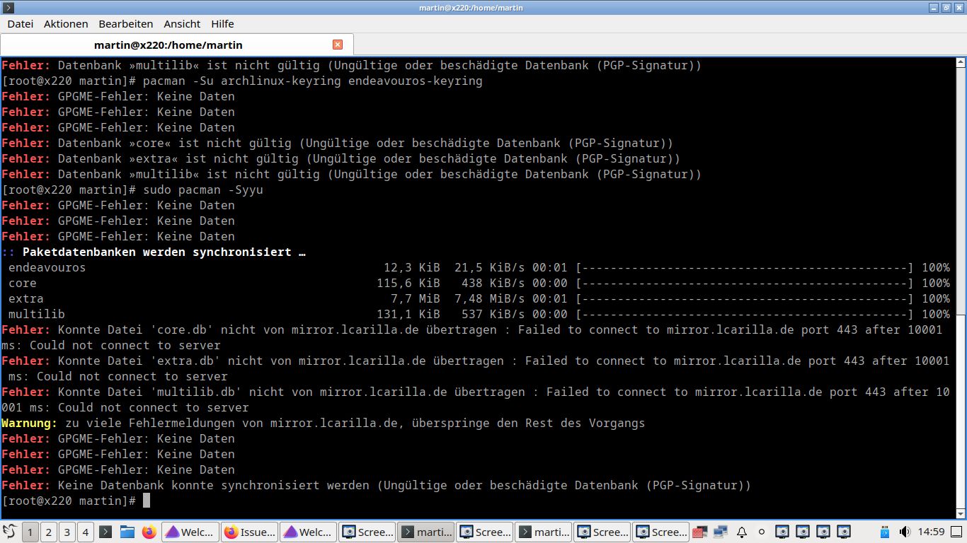

see what i am facing
database core
database extra
database multilib stilll not woriking - and pgp signature woring
are these findings still deriving form the mirrorlist !?
or does it have to do with other things … as well
look forwrad to hear form you
and a big big sorry for all the newbie questions here - its ashaming - am ashamed :face_with_hand_over_mouth:
So I assume you also did this ?
sudo rm -r /var/lib/pacman/sync/
If that did not help I am sorry to say I’m out of options here.
Maybe somone with a little more knowledge will come along, but as I see it , doing a reinstall after backing up important files would be your best bet.
how about post the contents of pacman.conf and of your mirrorlist.
also in your above command where you try to do the key rings I think you have the wrong command it should be
sudo pacman -Sy archlinux-keyring endeavouros-keyring
I have found this set of commands to work when resetting the gpg keys:
sudo rm /var/lib/pacman/sync/*
sudo rm -rf /etc/pacman.d/gnupg/*
sudo pacman-key --init
sudo pacman-key --populate archlinux endeavouros
sudo pacman -Sy --noconfirm archlinux-keyring endeavouros-keyring
To regenerate mirrorlist:
sudo reflector --latest 10 --sort rate --protocol https --save /etc/pacman.d/mirrorlist
And, finally:
sudo pacman -Syyu
