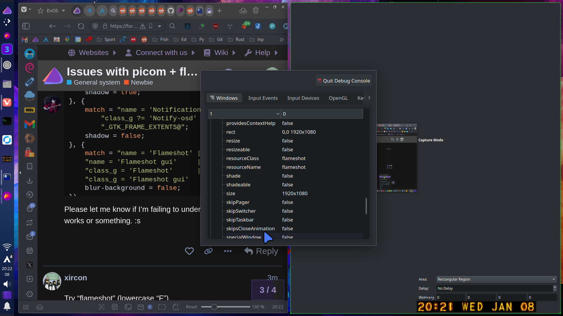

Try “flameshot” (lowercase “F”).
I’ve tried with a lowercase f too, and still no luck. Something else must be wrong if this is the correct way to exclude it. :confused:
My first thought was that the overlay screen capture that comes up when you press shift+prtscn had a different name than the other components of flameshot but that might be wrong thinking cus I don’t know how flameshot splits its elements up. But I think picom should detect all child elements of a program anyway? So idk if that would be the issue.
The above is plasma wayland, definitely lowercase. Been years since I used picom so can be of no further help :frowning:
It’s strange that it isn’t picking it up. Thank you for the suggestion though! If all else fails I can make a git issue on the yshui/picom git.
If this is the case, then “flameshot launcher” may work.

Hmmm. I’m still not getting a result, so there must be something else wrong other than the configs.
	match = "name = 'flameshot'	|| "
	"name = 'flameshot launcher'	|| "
	"name = 'flameshot full'	|| "
	"name = 'flameshot gui'		|| "
	"class_g = 'flameshot'		|| "
	"class_g = 'fameshot launcher'	|| "
	"class_g = 'flameshot full'	|| "
	"class_g = 'flameshot gui'	";
	blur-background = false;
	blur-background-frame = false;
Thanks for the help so far, I’m going to open up a git issue and see if they have any insight over there.
