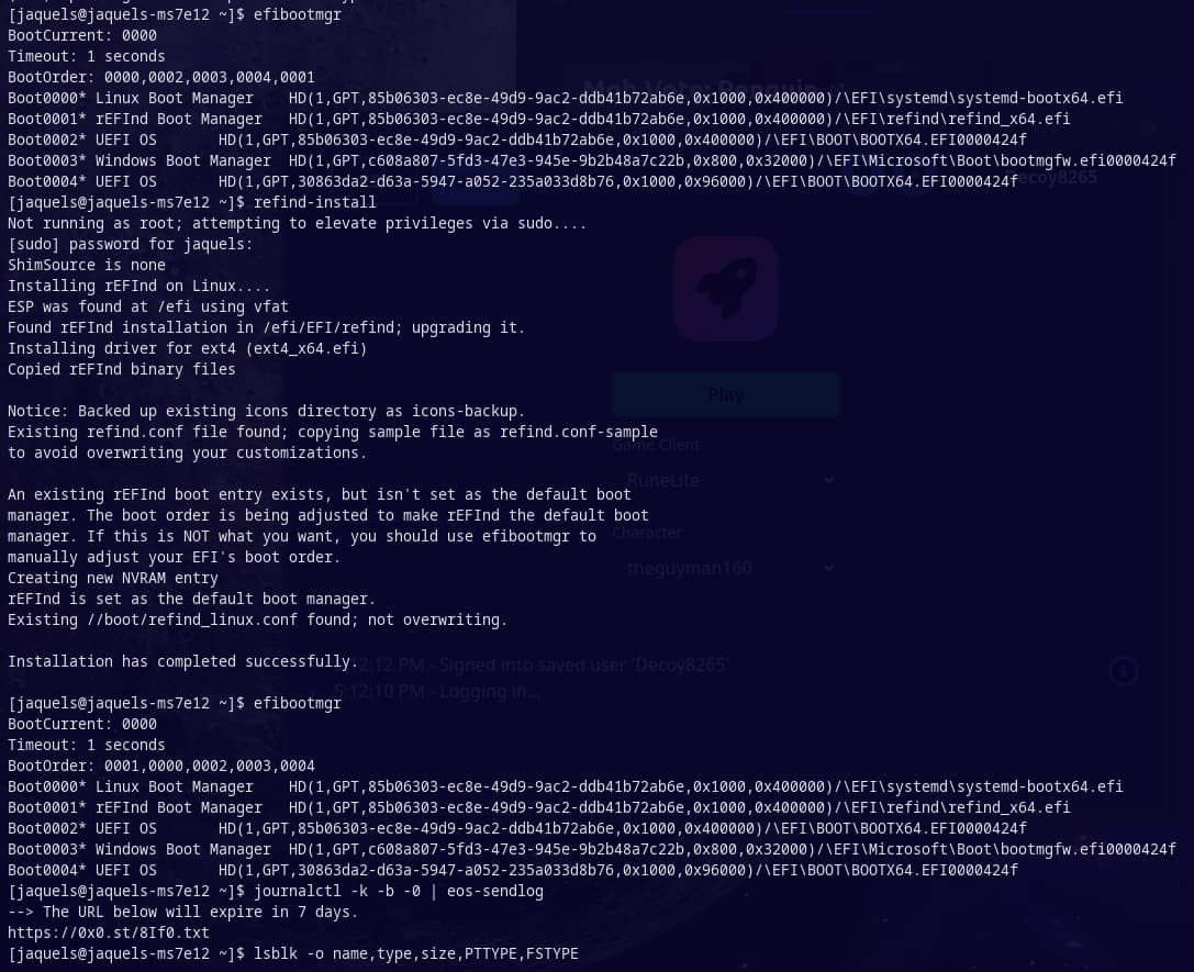

I have tried switching to the rEFInd boot manager. I have rune rEFInd-install, and it reports a success. Running efibootmgr before and after running rEFInd-install shows an option for the rEFInd Boot Manager. After running efibootmgr, rEFInd Boot Manager is listed as the first in the BootOrder, but after restarting, the same boot menu shows, and when I use efibootmgr again, the default boot manager has changed back away from rEFInd Boot Manager.

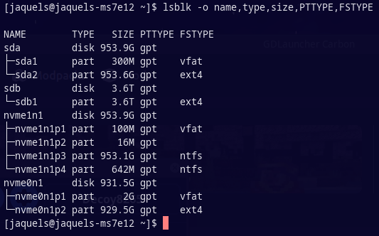

And here is my partition information:
Here also are the efibootmgr results, before and after using refind-install. After restarting the system, the BootOrder reverts to the first output, and I see no change in the boot menu.
Did you change to Refind boot loader from within the BIOS, otherwise the BIOS will “overwrite” the efibootmgr settings.
Hello, thanks for the response. I found the option in the BIOS and changed it. I am now booting to the rEFInd menu, and can boot into either EndeavourOS or Windows instance without issue. Thanks again.
