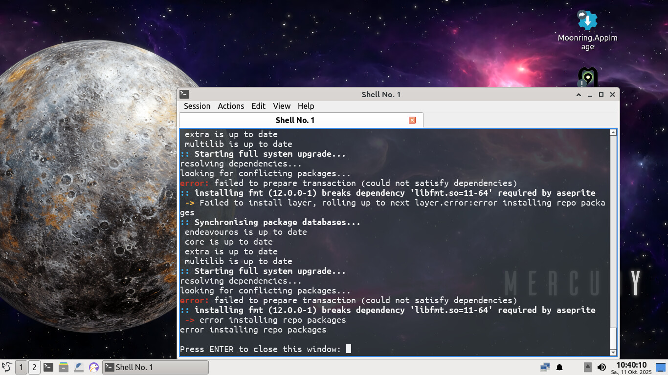

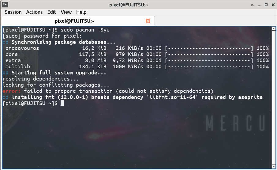

Yesterday i wanted to do my weekly update and ran into an dependency issue caused by libfmt.so used by aseprite. I updated my mirrot-lists and also tried to update aseprite via yay but the problem remained.
If someone could please tell me what is wrong and how to fix it, i would be really grateful.
[pixel@FUJITSU ~]$ yay -Syu
[sudo] password for pixel:
:: Synchronising package databases...
 endeavouros is up to date
 core is up to date
 extra is up to date
 multilib is up to date
:: Searching AUR for updates...
:: Searching databases for updates...
:: 4 dependencies will also be installed for this operation.
   extra/clang   -> 20.1.8-2
   (make dependency of aseprite)
   extra/cmake   -> 4.1.2-1
   extra/gn      -> 0.2238.a84e399f-1
   extra/ninja   -> 1.12.1-2
:: 113 packages to upgrade/install.

error: failed to prepare transaction (could not satisfy dependencies)
:: installing fmt (12.0.0-1) breaks dependency 'libfmt.so=11-64' required by aseprite
 -> Failed to install layer, rolling up to next layer.error:error installing repo packages
 core is up to date
 extra is up to date
:: Starting full system upgrade...
resolving dependencies...
 -> error installing repo packages
[pixel@FUJITSU ~]$

That is because your AUR package is built against an older dependency. Remove the AUR package, update and rebuild it.
Like this:
sudo pacman -Rdd asperite
yay -Syu asperite
