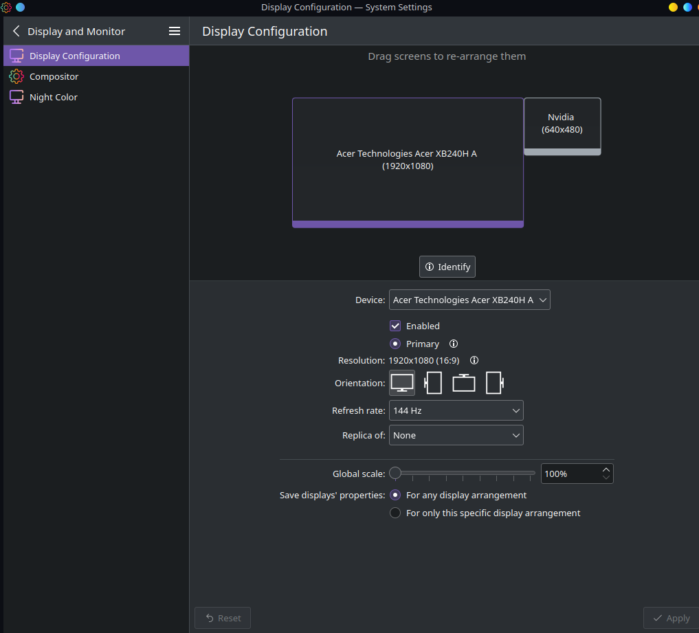

In the below picture, you can see the Display Configuration in its broken state after waking up the pc from sleep.
My normal configuration is set up in this manner from Left to Right
Primary
Model - Asustek Computer INC VG27A
Resolution - 2560x1440
Secondary
Model - Acer Technologies Acer XB240H A
Resolution - 1920x1080
But for some reason it flipped and it forgot what my other monitor is.

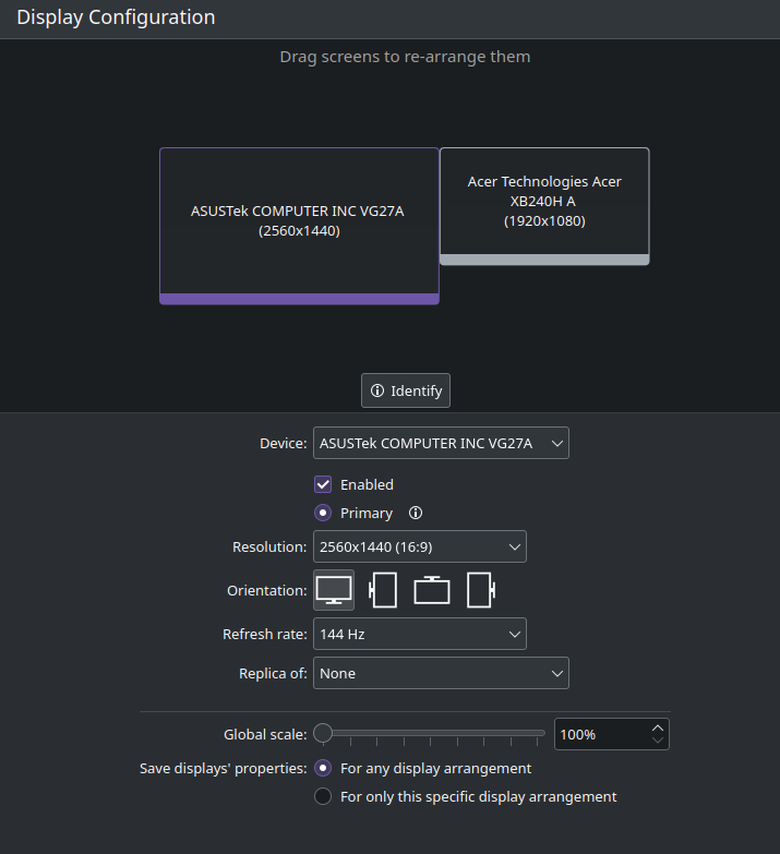

Below is the normal configuration.
