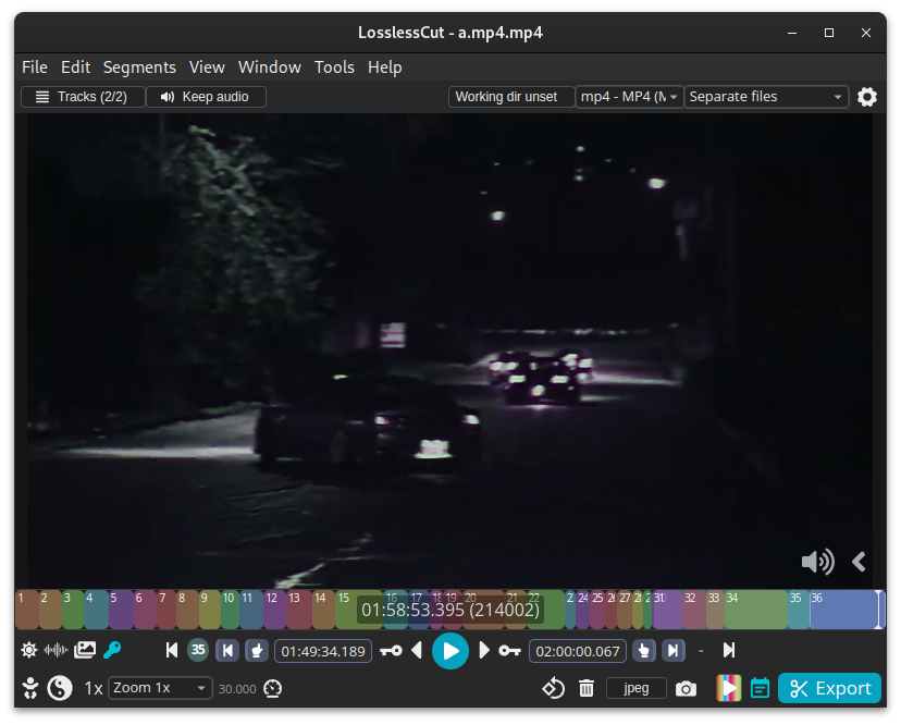

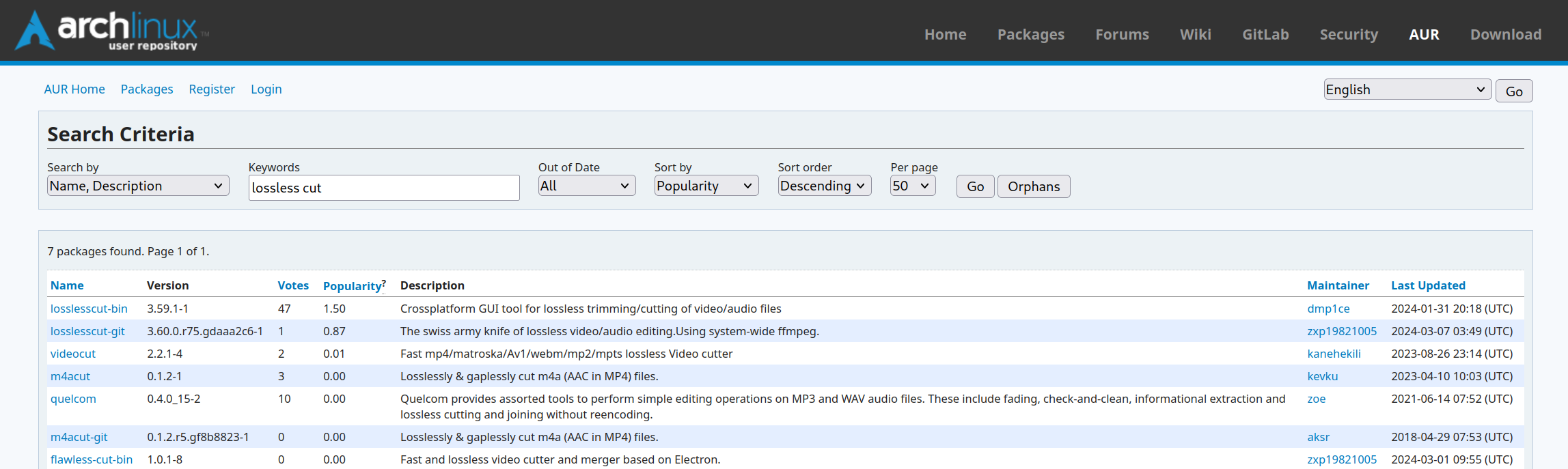

Sure. I get it. It wasn t my intention to drop the ball. How I solved the problem was to select a different losslesscut submission in aur. I initially chose, losslesscut-git, (the one that was most reciently updated.) It had the error. When that didn t work I chose (losslesscut-bin). It had no error, so that s what I went with.
Not a very glamorous solution for future generations, but it worked for me. In this case, (for posterity sake), I would refer future generations to the link you provided,
Between,
paccache -r, paccache -rk1, paccache -ruk0
I was able to free up 2.3 GB of space.
