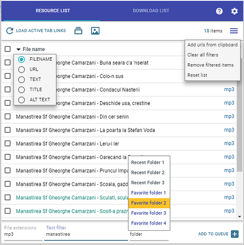

Perhaps this Firefox’ addon?
Question 1. How to use this extension?
Answer Say for example you have opened a web page with many pdf resources. The most basic workflow it to open the extension popup (via the browser toolbar icon) and click there the Load page links button. This usually fills the resources list with all sort of links, not only the desired pdfs. So the next step is to filter this list, such that only desired pdfs stays here. Write pdf in the extensions text field. Now only pdf type resources show in the list. If the list is still too large (you want only smaller subset) you may continue the filtering process indicating some relevant terms in the next text filter field. Finally, you check desired items individually or all at once and start immediate downloading using the corresponding button (on right bottom corner).
The downloading items are now visible in the downloads tab of the popup; you can manage this list in the usual manner (pause, resume, open or remove individual items etc)
Thanks, I’ll try it now!
It’s downloading HTML links but not the PDFs.
