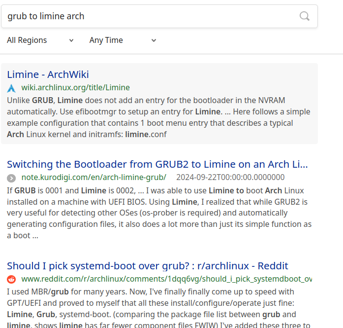

while both these threads don’t answer your question directly, they do talk about this so there might be some valuable clues in there.
also I saw:
good luck
