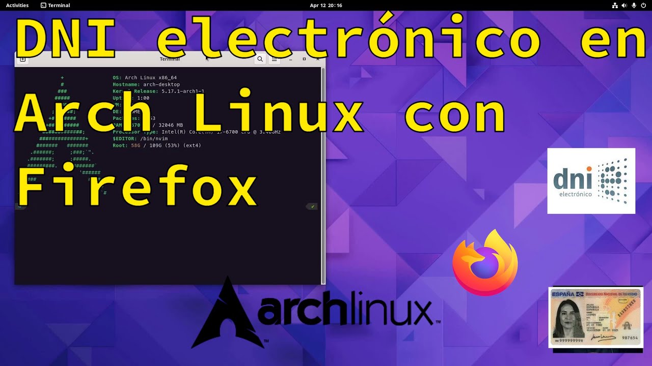

Arch guide:
https://wiki.archlinux.org/title/User:Timofonic/DNIe_(Español)
Youtube guide:
The problem is that now the DNIe chip is 4.0 and I had the 3.0 chip, so now that I have the 4.0 chip I need a card reader and they do not allow me to use other means such as “Cl@ve”.
I couldn’t buy the reader yet, so I haven’t been able to test it yet.
