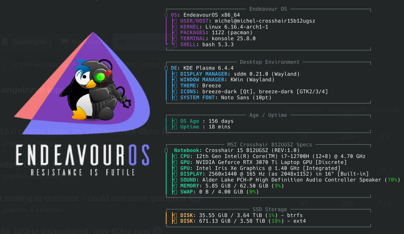

As I said in my message: same computer, same version of EndeavourOS up-to-date (3 installations where only the Window Manager differs), same DNS (resolv.conf), same connection, different behavior… I cannot explain that

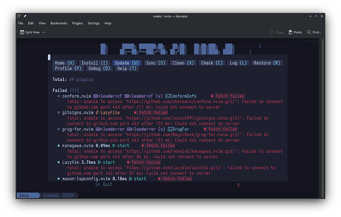

I’m also experiencing this problem. New pages/tabs will not load, images won’t load but page will, page loads halfway. Sometimes a refresh will fix it, other times it will not. This may not do any good since the source of the problem was already found, but I wanted to add my experience with what I’m using and what I’ve tried.
Browser: Firefox 142.0.1 (64-bit)
EndeavourOS: 6.16.4 (rolling)
DNS: I have tried 9.9.9.9, 1.1.1.1, and 8.8.8.8 and it happens on all of them
Like @Moonbase59, I also have my DHCP pointed to my router for DNS queries, and the router has the DNS on WAN that I choose to use (tried all 3 and no resolve, clearing DNS cache each time).
My main MSI gaming notebook does have the internet issue as well.

And here are the same problems:
