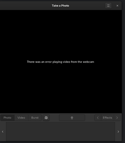

I tried to launch Cheese but it does not open.

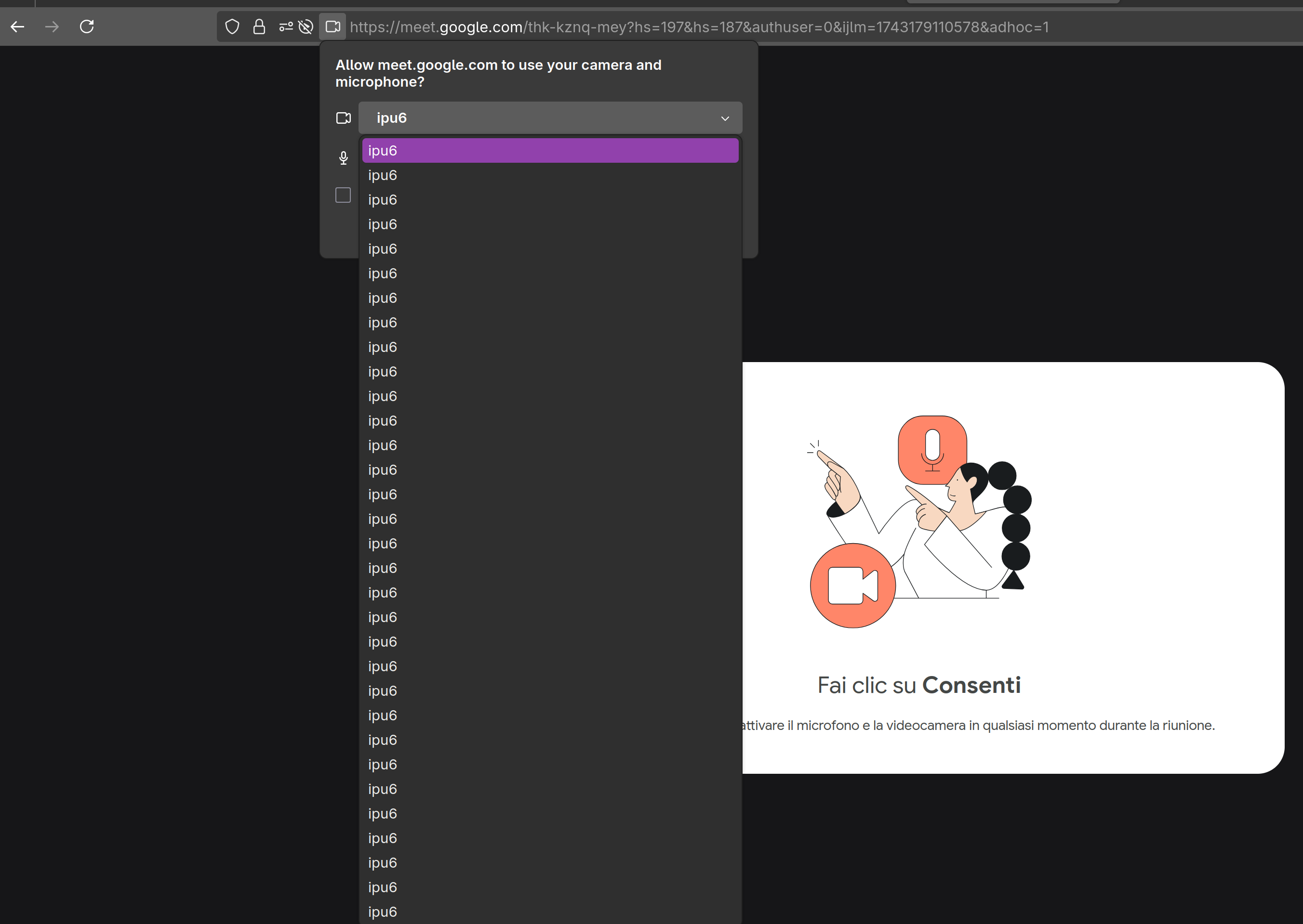

I tried Google Meet. See attached a screenshot with the error I get.

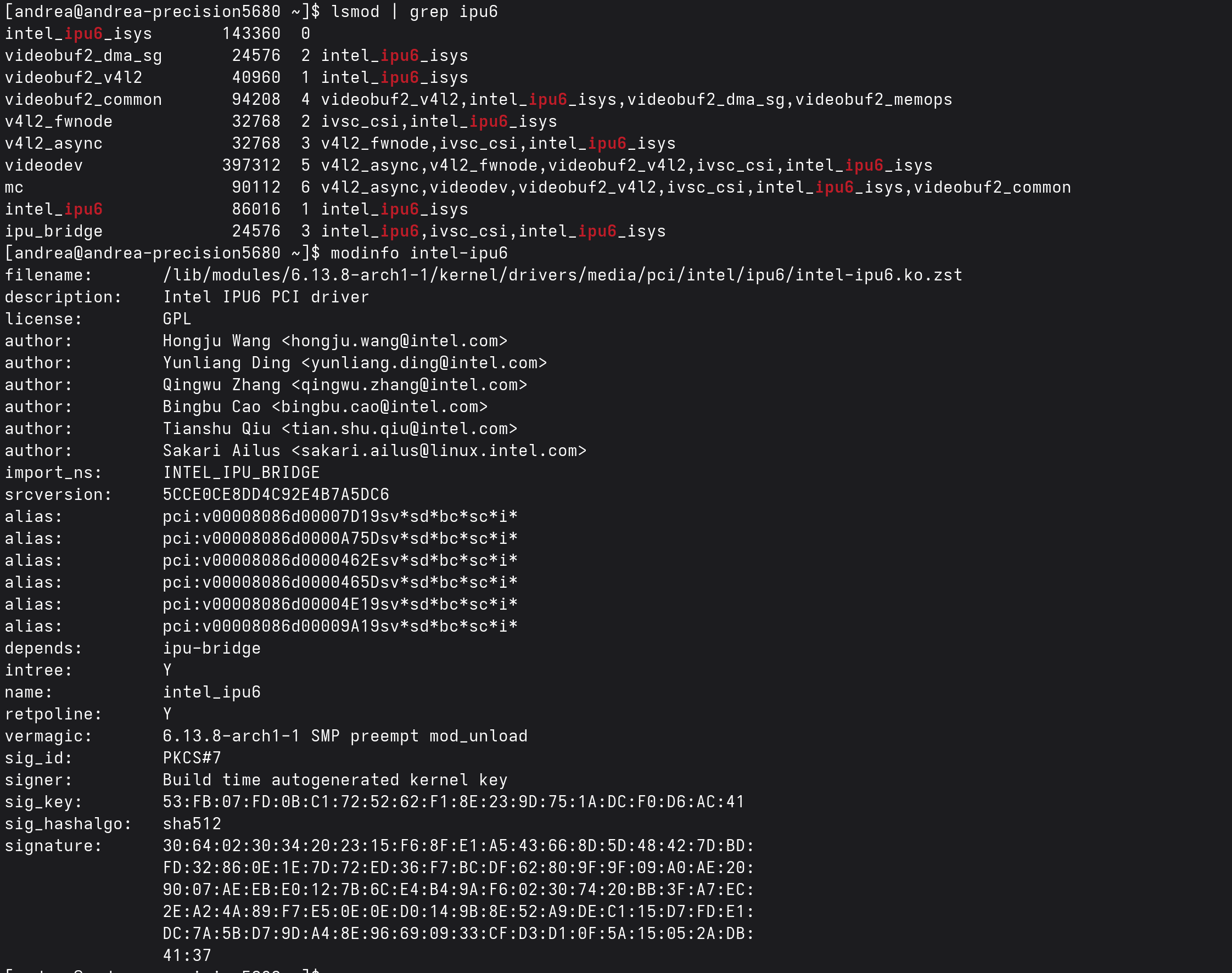

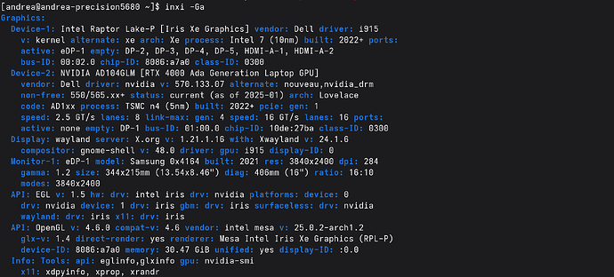

Share the output:
inxi -Ga
lsmod | grep ipu6
modinfo intel-ipu6
I tried with Cheese but it does not open.
I also tried with Google Meet. See attached a screenshot with the error I get
The modules are already loaded so I don’t know what is wrong.

When I launch Google Meet and try to select the camera, the dropdown menu shows many entries with “ipou6” as in the attached screenshot.
