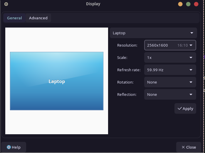

I just noticed that only the “default” resolution offers the korrekt refresh rate of my display: 90 Hz.
Every other resolution, which just turns black. does not offer this. Looking into it and posting it here as an FYI.
Default : settings screenshot
another: settings screenshot
