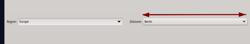

Installer UI gets clipped out on low resolution like 800*600
See the screen captures below. I think the [Change] buttons on the right are unnecessarily clipped out due to suboptimal layout. I mean, the region/zone drop-downs do not need be that wide, the labels (The system…/The numbers) do not need to be that wide either, and if space is really needed, they could be just
Language: American English (United States)
instead of
The system language will bet set to American English (United States).
And those [Change] buttons should be docked on the right border and not go beyond that. The map could use horizontal scroll, or the map is not very essential because the user can just choose the zone from the drop-down.
1920*1080
800*600

The size of the installer window (calamares) is set to a specific size to be able to show the pictures correctly for the most common resolutions.
And it is not us developing Calamares completely we only change some stuff downstream.
It was already not that easy to find a middleway to get the GUI showing nicely from 1024x768 to something hidpi …
So it would be best to report this upstream too
As long as the issue is related to something we do not changed here downstream … what is the case for this module.
Not forget to mention that calamares is qt-based and for EndeavourOS it runs inside XFCE4 gtk Environment can cause some issue in addition.
We do use qt5ct and Kvantum to theme the installer, this could be also part of the issue…
But a short test shows it seems also without kvantum the minimum size of the windows is casing the very right part of the window to be off the screen on 600x800.

There are 2 easy(ish) ways around this problem. One of them is to use the Welcome program to change the resolution to something more suitable - assuming that your hardware can support that, which it often can by scaling. If this gives difficulty, the settings app in XFCE, under display, gives more options for this.
The other is to use the arcane knowledge of the user interface (:grin:) In XFCE (which the live instance of EnOS uses) - it is possible to hold down the Left-ALT and use the left mouse button to grab and drag the window to where you can see whatever part you want. This should enable the process to continue to a satisfactory conclusion…
