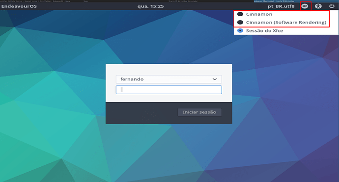

As for my problems with installing Cinnamon, my super noobiness strikes again! -Syu fixed it! Sort of. Cinnamon installed but when I was at the login screen, I didn’t see the option to select Cinnamon as my desktop manager. I think I’m just going to wait for the final product.
Come on July 15th!
I just installed Cinnamon and didn’t have any issue but i only used sudo pacman -S cinnamon. I don’t really like installing two desktops this way. I’m waiting for the online installer so i can choose. But right now i have no choice.
