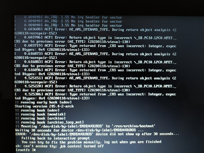

This is what happens whe i run the installer from the USB stick:

I get the Endeavour screen, and when I hit Install this happens.

OK, I added that, but it gave the same result.
You add to the end of the line and I’m not sure if you have to press f10 to save and then enter so it boots on it? That’s what i do on Bios but this is in UEFI mode i take it?
I added it to the end of the line. Here is the result:

hmm, i just realised, you shouldn’t be in a shell at all. the installer works in xfce X11 mode.
Looking at the screenshot, I think there might be a hardware or driver issue.
