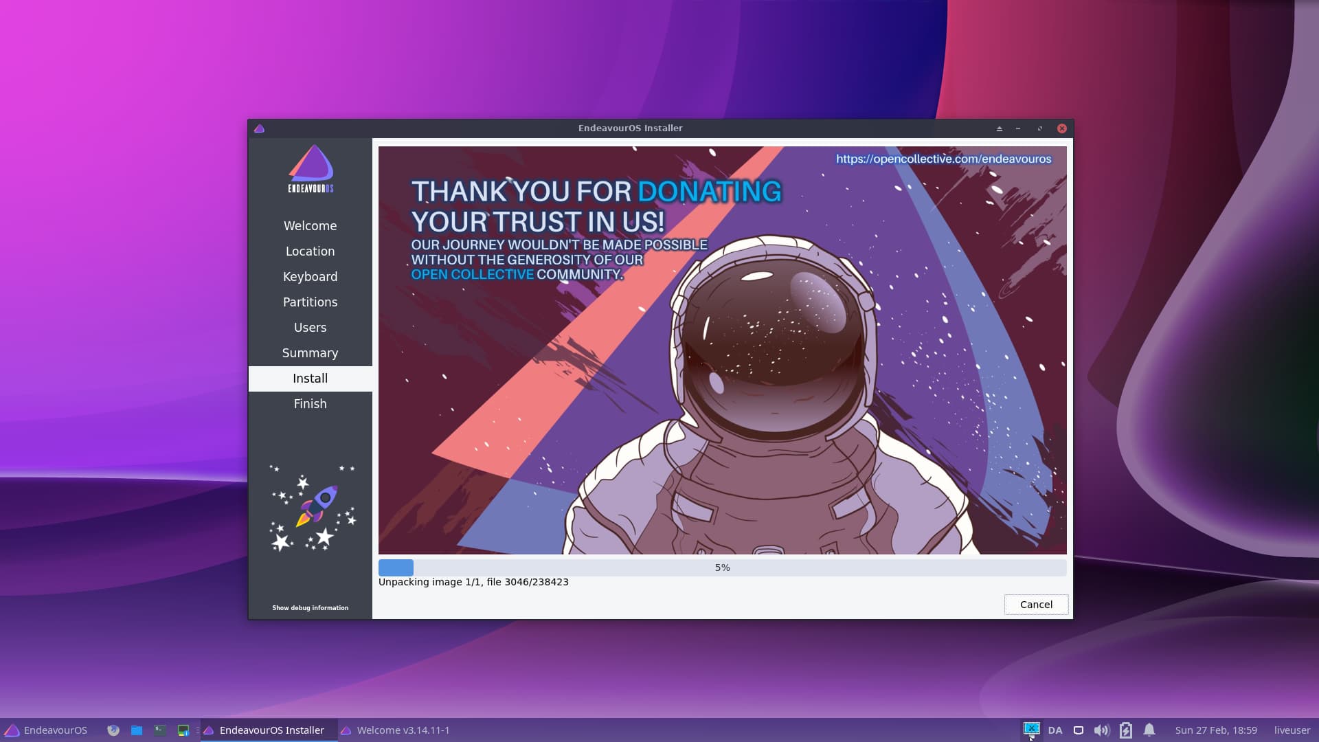

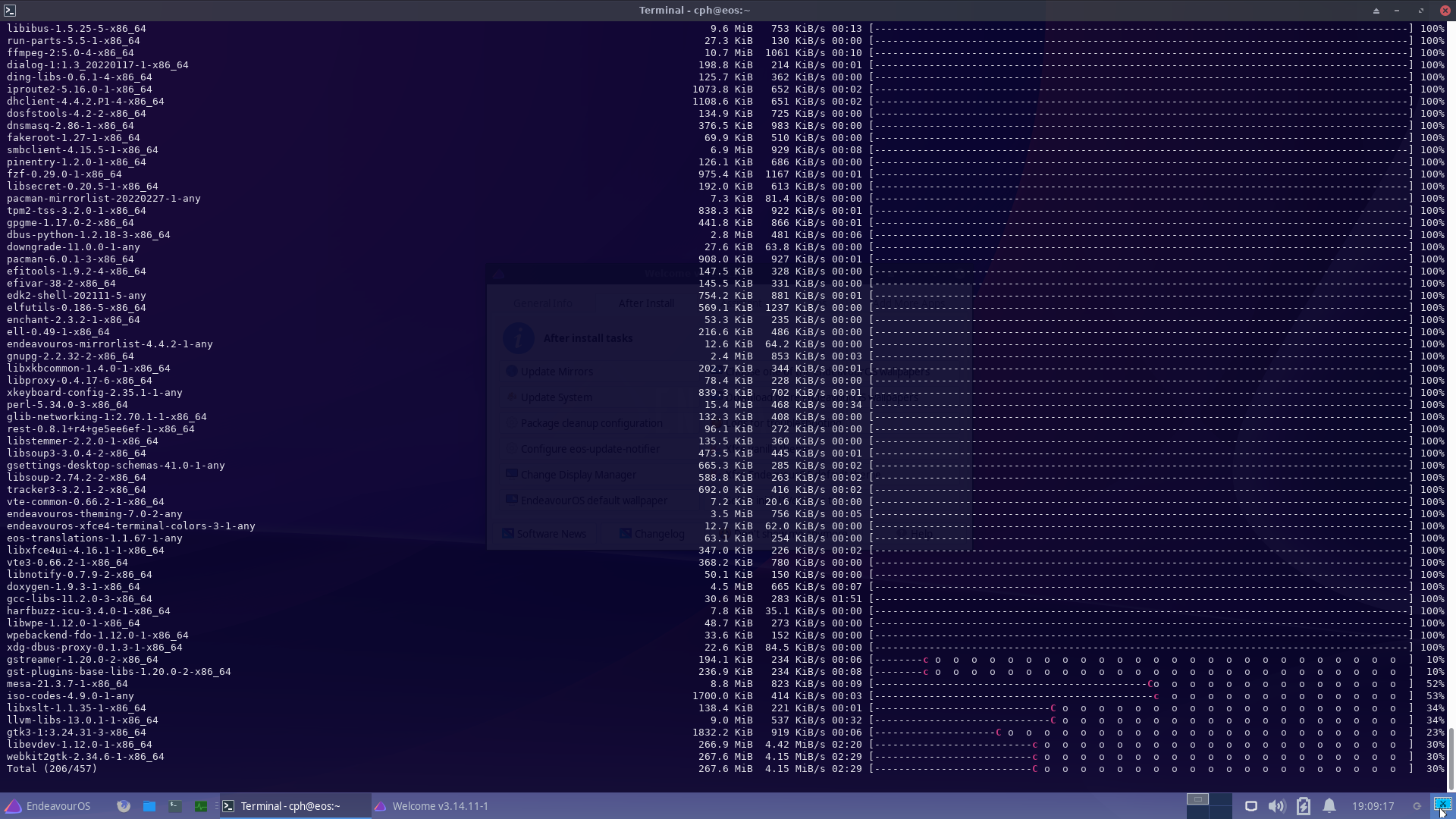

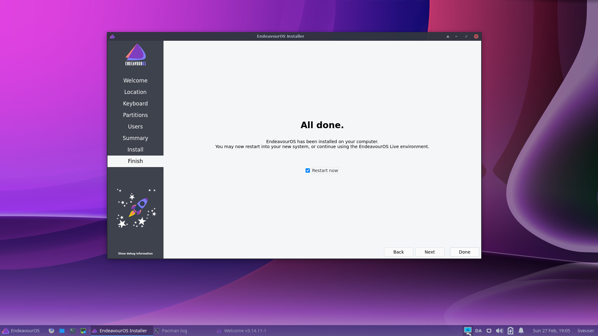

This was not hard or complicated
Screenshot_2022-02-27_17-58-09
Screenshot_2022-02-27_18-59-27
Screenshot_2022-02-27_19-05-36

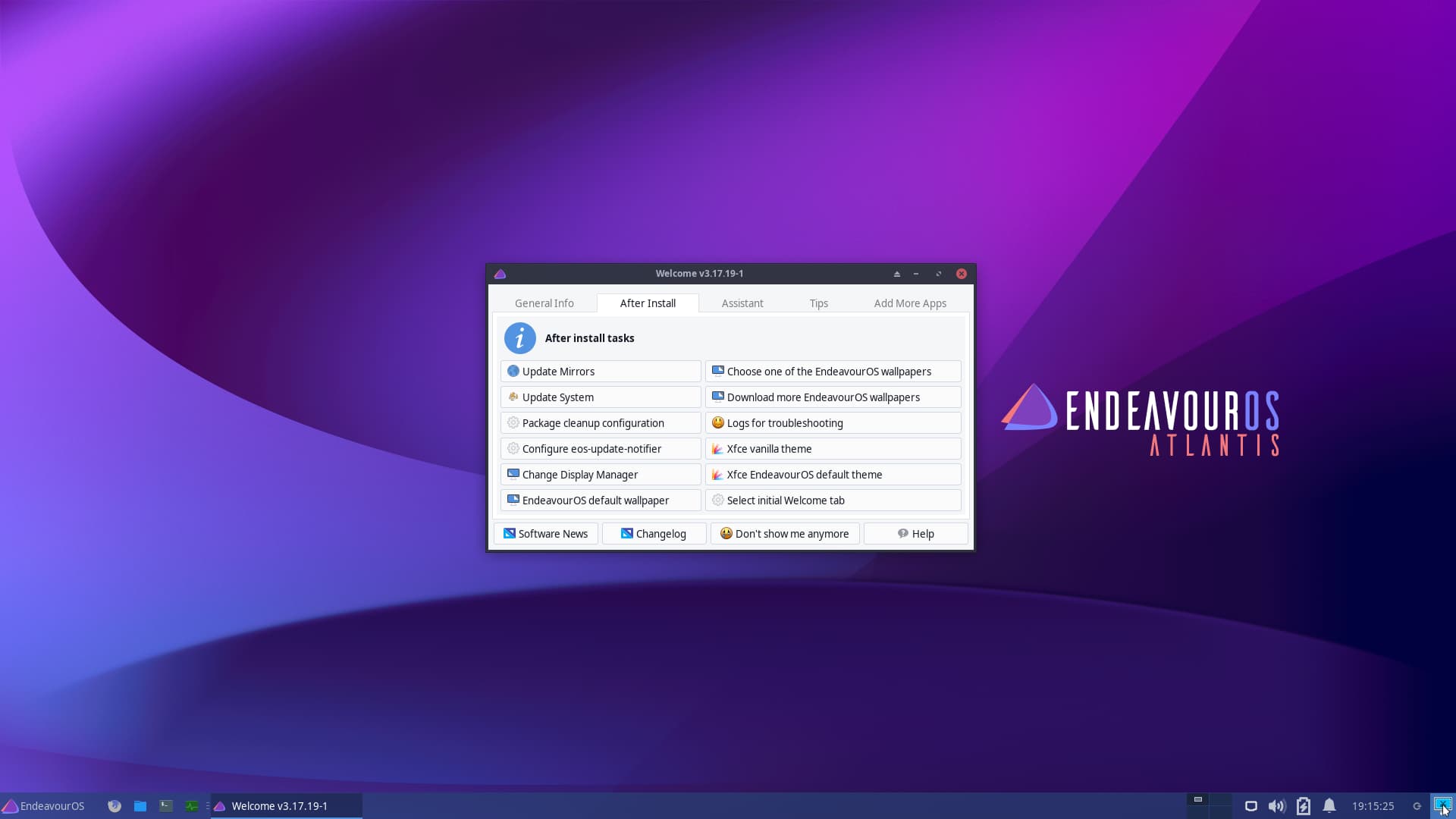

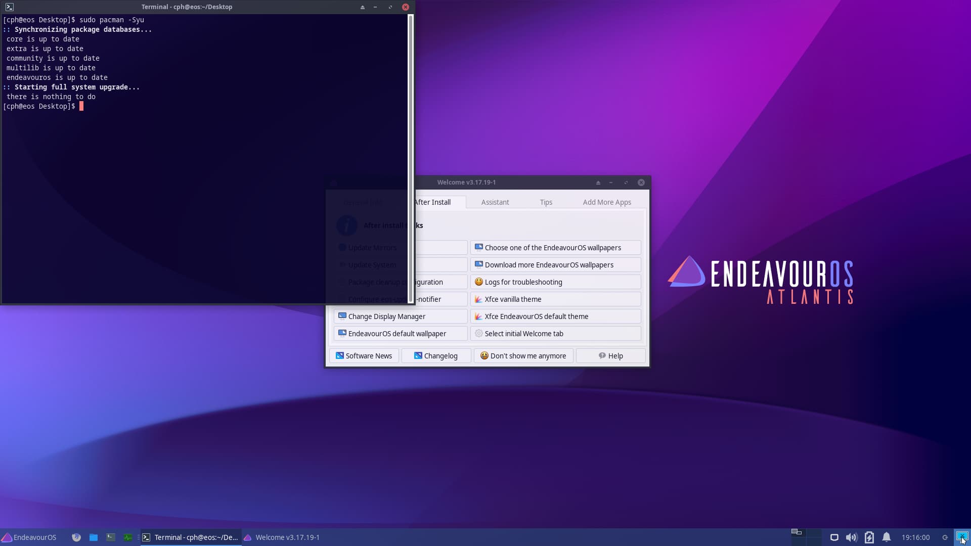

and full updated
Screenshot_2022-02-27_19-09-20
Screenshot_2022-02-27_19-15-28
Screenshot_2022-02-27_19-16-03
it was very easy :slightly_smiling_face:
