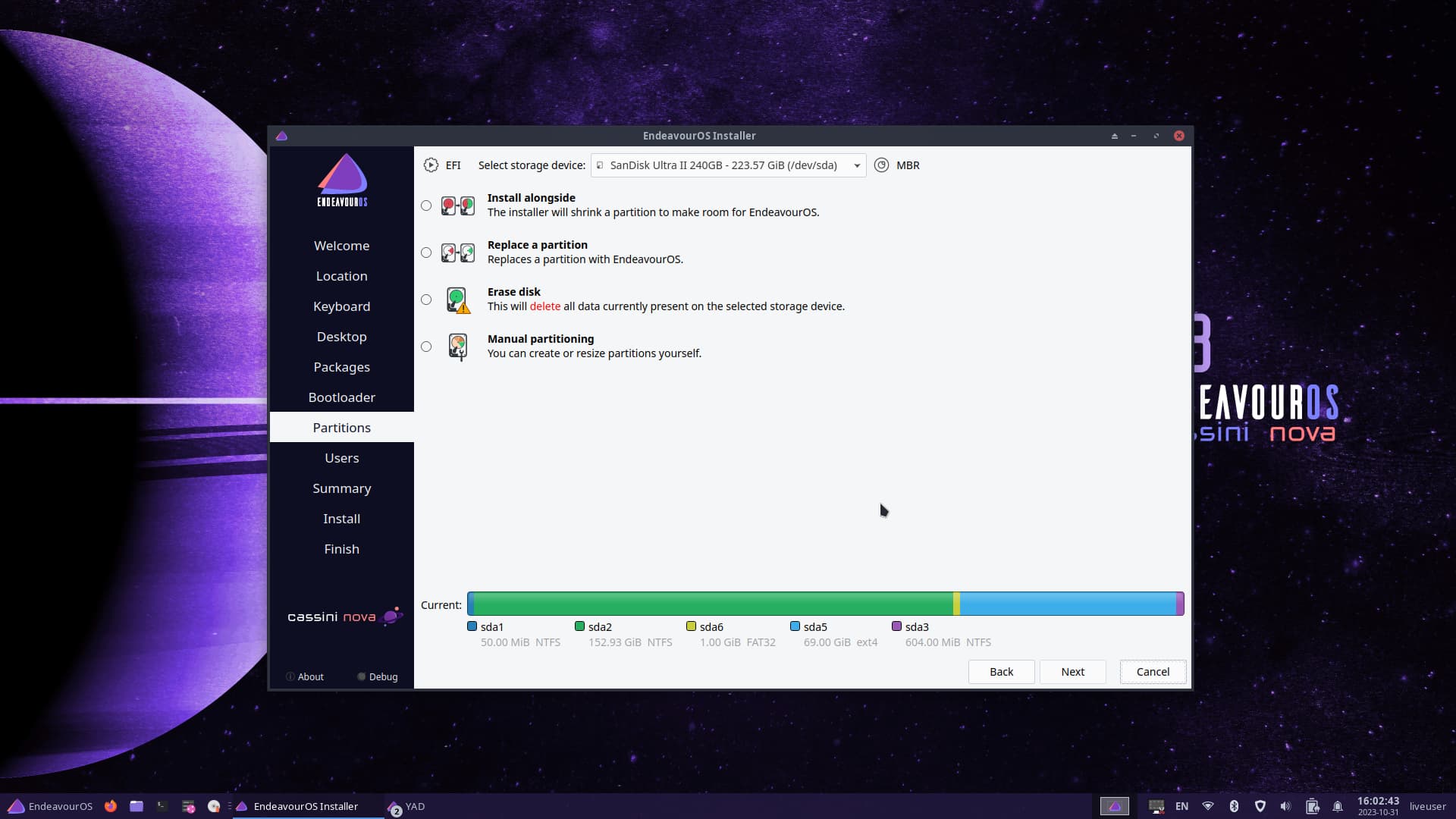

Hi, I am trying to install EndeavourOS on an extended partition
Here is an overview of the partitions setup:
/dev/sda4 extended
– /dev/sda6 fat32 /efi
– /dev/sda5 ext4 /
I am installing on an extended partition since for some reason i can’t use gpt, i’ve disabled legacy boot from my BIOS.
Every time the installation process reaches the bootloader step, it’ll fail with the following message:
Installation Failed
Boost.Python error in job “bootloader”.
No such file or directory “/tmp/calamares-root…/loader/loader.conf”
I read somewhere that i should’ve checked the format option, but there was no such thing.
The EOS version i am installing is the cassini nova.
Thanks
