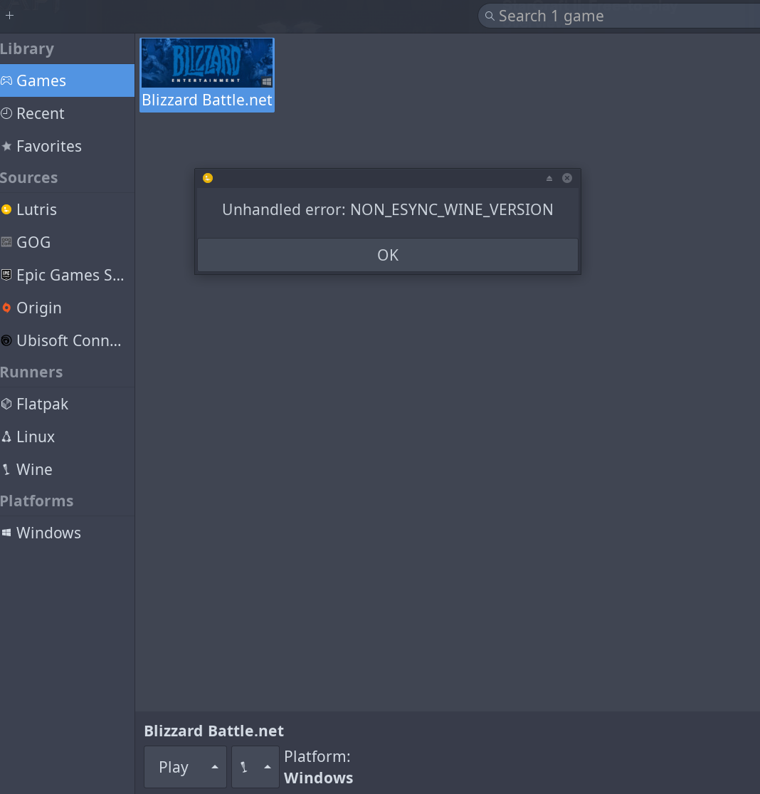

When I try to start “Battle.net” through the lutris interface, I get an error: “Non_Esync_Wine_Version” (see screenshot).

You should be able to turn off e-sync or experiment with other versions by right clicking the app and playing around with settings (sorry I can’t be more specific been a while since I’ve tried getting this running)
I played some time with the settings, but did not succeed: the user-experience while gaming remained poor. Still no sound.
