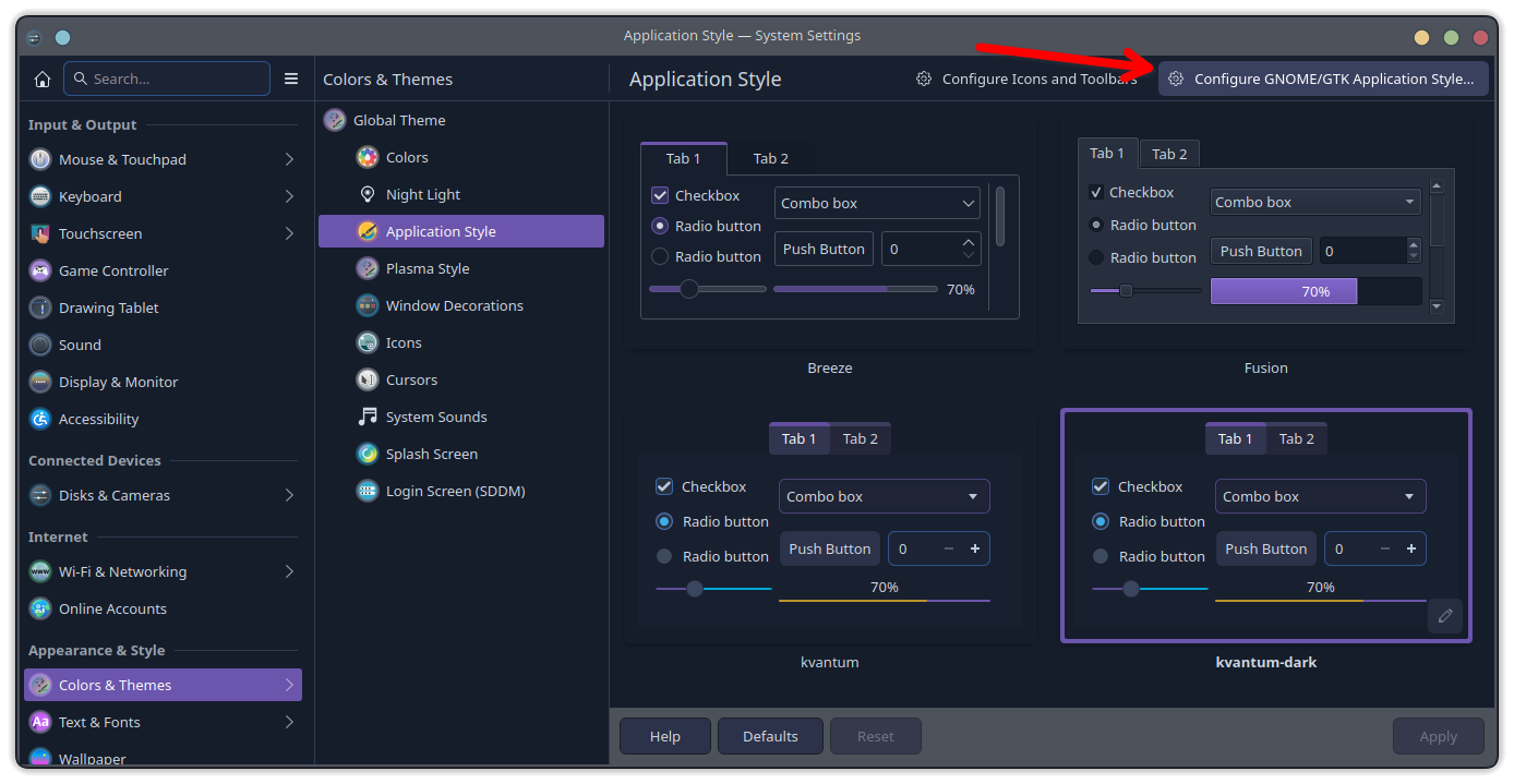

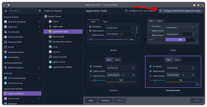

Another thing is to set the GTK theme in KDE System Settings. Can’t remember where to find it. Someone will maybe chime in and tell/show you where it is.
Can’t remember the other things at the moment.
