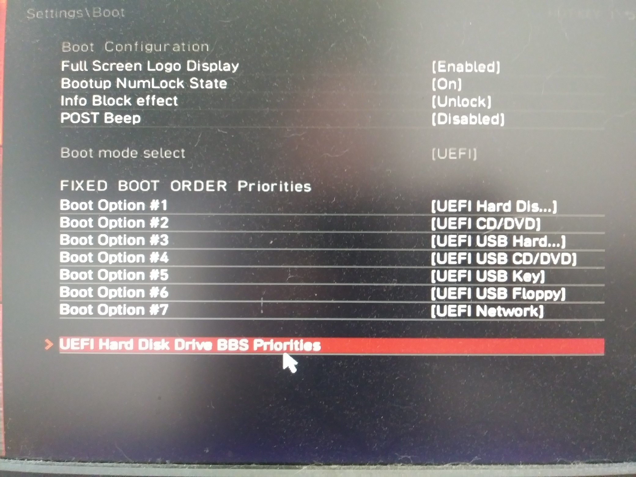

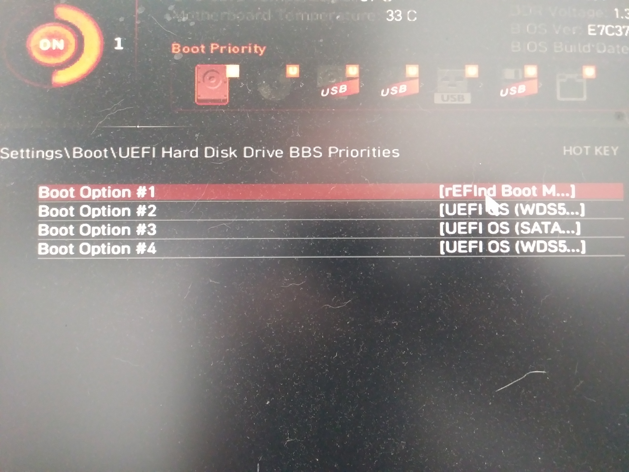

If you go into UEFI and disable the boot order for all except one. Most new UEFI have the ability to have multiple entries for boot.Then set the boot to boot on the drive you are installing to. UEFI keeps a running tab of boot entries in NVRAM.
Edit: I would use gparted and set new GPT partition. Then close and run the installer and erase disc and swap with or without hibernate. Or do manual partitioning and use 300M minimum for EFI and set it /boot/efi and flag /boot. Then create you other partitions for root and home and swap if that is what you want and proceed with the installation online.
i would try removing old entries from another working OS or simple reinstall refind from scratch
When you install rEFInd it adds an entry in the boot order to boot from rEFInd. Were most of these in rEFInd? I suggest on a new install to disable all boot order and set to boot only the drive you are installing to if using the whole ssd.
Edit: Not sure if the user is still going to dualboot with Windows 10?
I have never done it this way but couldn’t they just dd the whole drive and start from scratch?
Erasing the drive is only part of the equation. The problem is UEFI keep the entries in NVRAM. On my board in UEFI i can disable all boot devices except the one’s i want. Because UEFI keeps a list and rEFInd installation creates a boot in the boot order to boot from rEFInd. So you need to change that and clear them. User has many many in the list.
Edit: 20201008_133244
20201008_133307
Hi, yes many!
I deleted what entries I could from the bios, this allowed me to delete more using sudo efibootmanager -b xxxx -B whilst in a live environment.
The result is a fully installed and functional gnome desktop. Yay.
