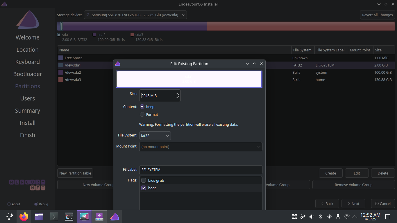

I made 3 partitions as per the the photo below.

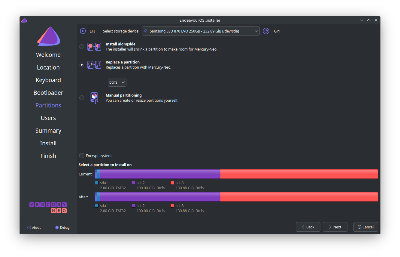

The second option “Replace partition” “Next” button does nothing.
The third option gives me the three partitions and next button takes me to next screen (photo below)
I am having a little issue as I am not sure what check boxes for each partition should be checked (the small window boot, bios-grub…etc)

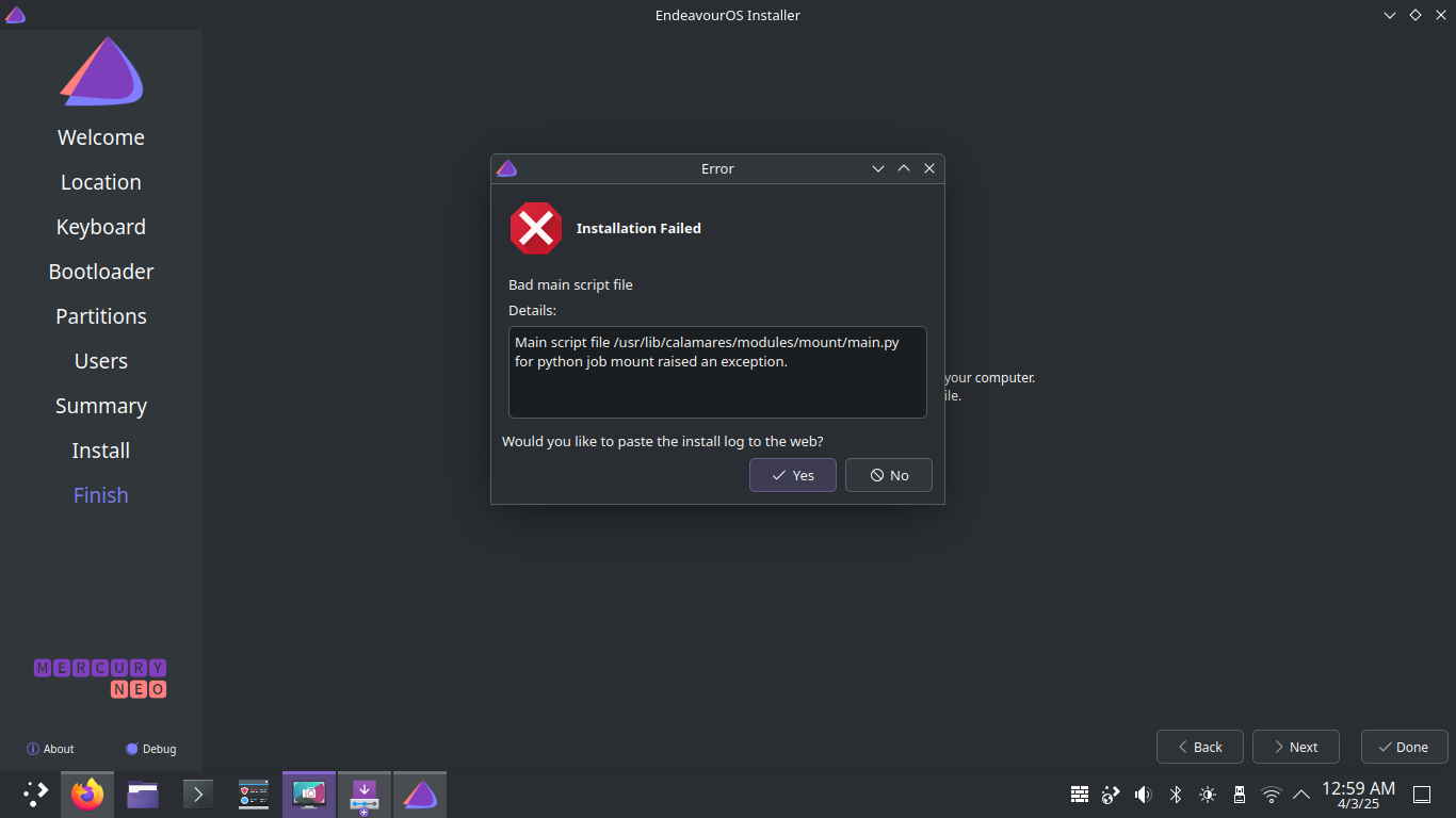

As well, I tried to figure out and maybe I did mistakes as after finishing this stage and start entering user name and login password I get an error as in the photo.
I don’t know what exactly I am doing wrong or why this error.

I think if you answer yes to get the install log that would give more info about what was wrong.

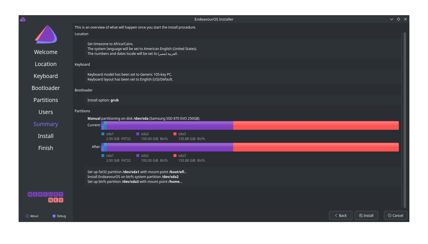

I consulted and did what phind.com suggested as follows:
File System: BTRFS
    Mount Point: /
    Encryption: None
    Flags: Check "Boot" box
    Compression: Already enabled by default (no action needed)
    File System: BTRFS
    Mount Point: /home
    Encryption: Select LUKS encryption
    Set your secret password here
    Flags: Leave empty
    File System: FAT32
    Mount Point: /boot/efi
    Encryption: None
    Compression: Not needed (small partition anyway)
But I did not see anything asking me about LUKS password to encrypt any partition. I guess I will do it manually.
